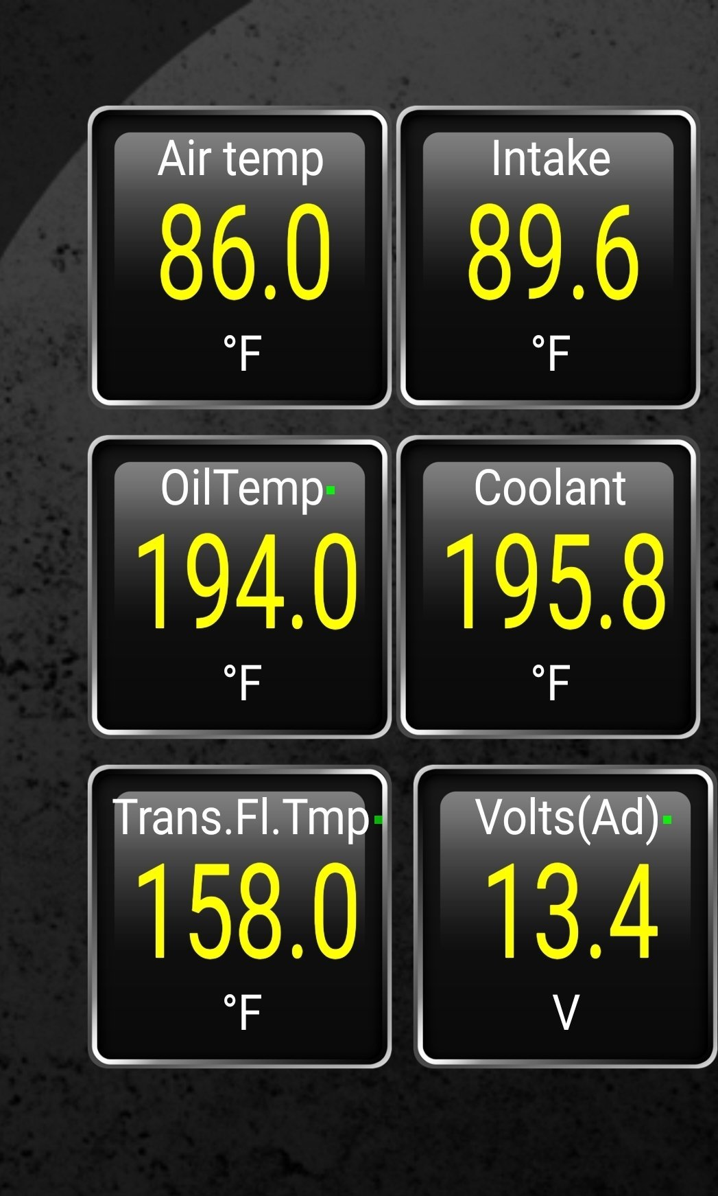

This is my go to custom screen on Torque Pro and just a sample of what you can monitor.Screenshot_20230715_171453_Gallery.thumb.jpg.0fec66f0f9f181607544fd961218ad76.jpg

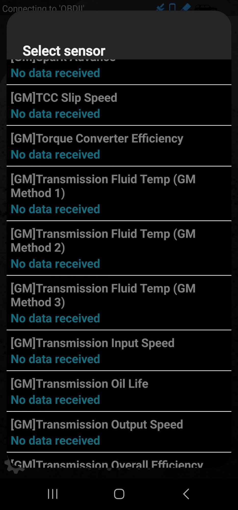

Also my transmission temperature PID is not working - the PID code from the preloaded custom GM PIDs is identical to the PID I found online for creating a custom gauge.
3 hours ago, BlaineBug said:
There are Method 1, Method 2, and Method 3 under GM specific choices for the Trans Fluid Temperatures. I don't recall which one I used but it does match the DIC display for Trans Fl temp.
Edited by mikeyk101
I see nothing of the sorts in my app.

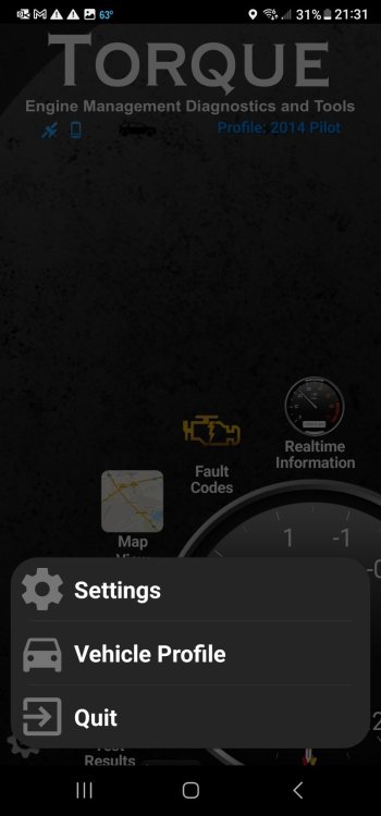

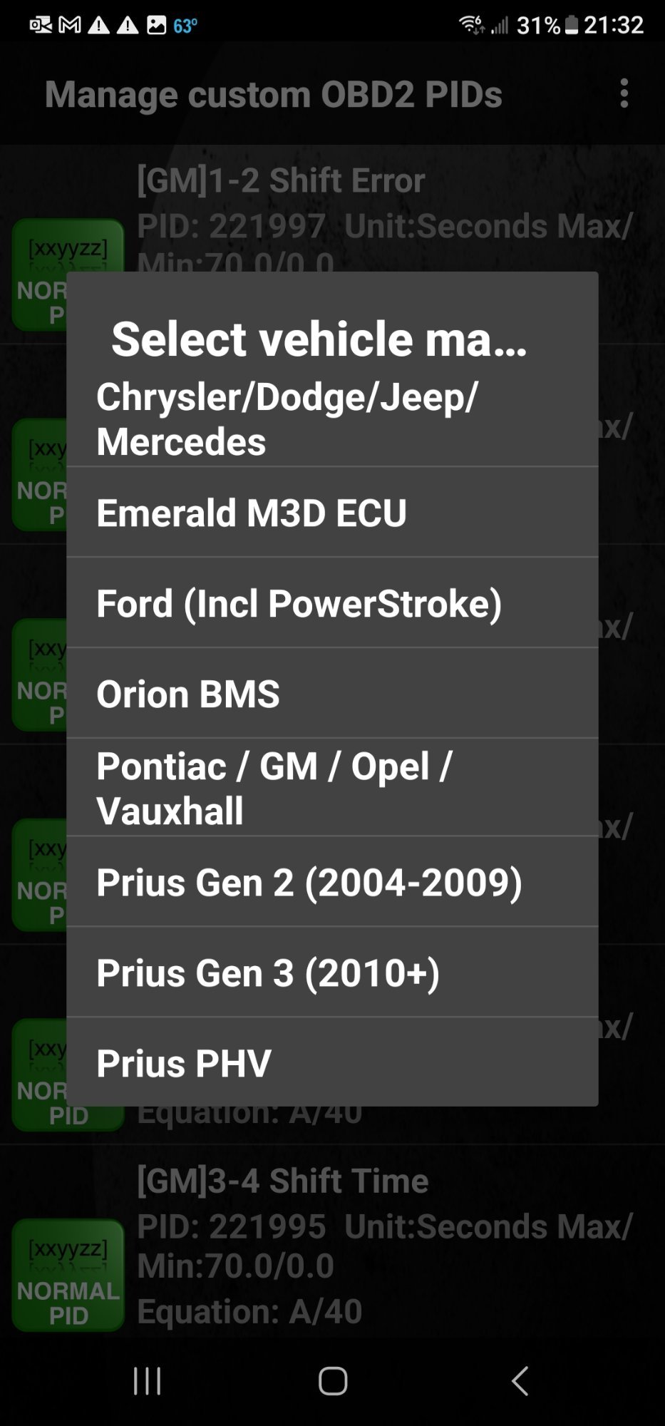

Did you add the predefined sensors in settings on main page of app? You need to click on "Manage extra PIDs/Sensors" and the click on the 3 dots on upper right and then select "add predefined set" and finally click on the the predefined sensors for "Pontiac / GM / Opel / Vauxhall" and all the extra GM PID's should show up
