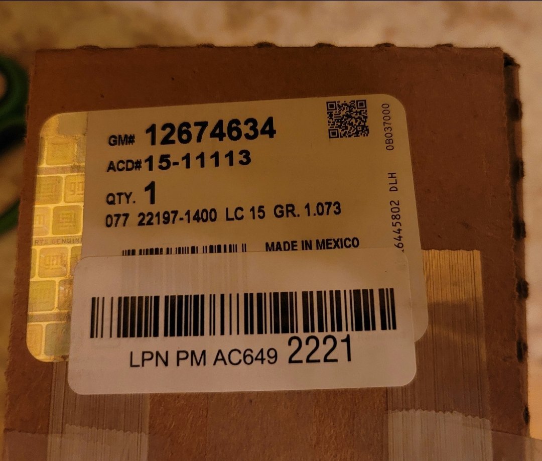

Mine also had part number on the side of the plastic base. Im pretty sure it was the 12674634 number but of course it's on the one side that I can't see right now. I did match up the numbers with the numbers on the box to make sure. The box listed both numbers on it. The AC Delco # is the 15-11113 number and the GM # is 12674634.
Here is a pic of the box.Screenshot_20230825_205329_Gallery.thumb.jpg.c9c98dc153e933a903ee8ff15dc62c16.jpg
Yes, one part number is an AD Delco part number and the other is a General Motors part number, it's the same thermostat, but if you search them individually and uniquely on eBay, you'll see that the prices vary by about double depending on which one you use as your search term!
