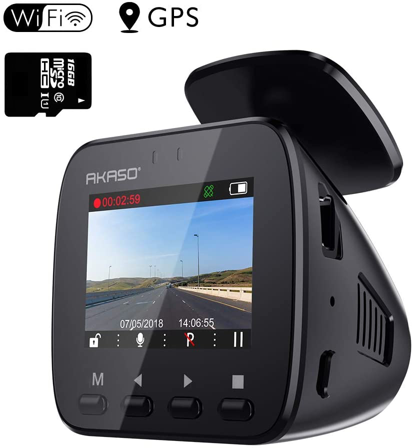

I have these (front and rear) on my Silverado and my wife's CRV.......Video is excellent, they stay stuck on the Windshield, very small and inconspicuous,  and they last a long time.
Had these on my prior vehicle for 4-years with zero issues.
$55.00
Saved me big time when it captured a wrong way driver coming down a freeway exit ramp and we collided head-on........they tried to make up some stories.......video shown, case closed!
https://www.amazon.com/gp/product/B07SZNN5RK/ref=ppx_yo_dt_b_search_asin_title?ie=UTF8&psc=1
