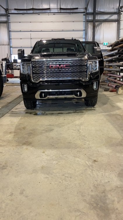

I'm considering adding an additional LED light, either a light bar or additional LED driving lights.  It looks like the only spot would be behind the grille, I really don't want to add a bull bar or anything like that.  HAs anyone added any yet?
Not my truck, but here ya go. Not sure how well it would work on a Chevy, but it works well with the Sierra AT4 grille

I put a light bar on my AT4 with no issues. Ended up popping two of the blades out just because my mount was slightly too far back and I was too lazy to take it off and cut the steel again.

I got a 31" light bar behind the grill , mounted under Z71 grill emblem - NO PROBLEM

25.6” light bar tucked up way at the top of the grill! Single row Jiuguang from Amazon, been 2 years on 2 trucks.
A couple zip ties to hold it makes for a quick uninstall, zoom in two rows above GMC logo.

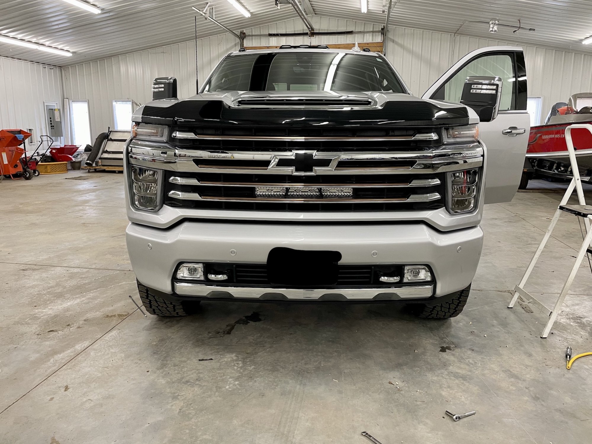

Got it done.  I ended up using zip ties to attach it to the back of the grille.  It clears the shutters no prob.  I tapped the high beam fuse under the hood so the high beams activate the relay to turn it on.  I may add an additional on/off switch at some point depending how I like the high beam setup.  The nice part is I didn't have to drill any holes or cut any factory wiring.
