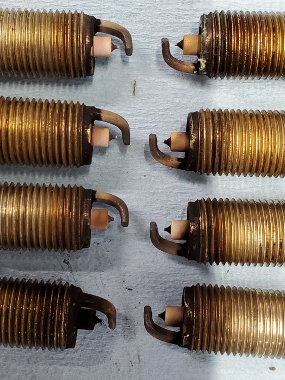

Decided to spend some stuck at home time to replace my spark plugs. 2018 only has 44k on it (mostly local but around 1/4 longer multi day drives), but this is my third truck with active fuel management and cylinder deactivation, so I am always suspicious of fouled plugs. Truck was running OK, but idled rougher than when new. Here's the pics. Unfortunately, when moving the plugs they got mixed up (good shop help is hard to find and he reminded me I pay him nothing ?). I believe the oil soaked darker one is from the right rear (passenger) spot (#8).
New plugs and wires are in. I'll probably run them for about 5-10k and check again to see if it is persistent.

Are you using/losing any oil?
Someone else just started a thread on his truck going through 1.5 quarts of oil in X amount of miles. Just curious, with the one plug being pretty "oily".

Hmm.  The oily one, if pulled from #8, is a non AFM cylinder.  I wouldn't be surprised to have seen that plug come from cylinder #7 the driver rear (an AFM cylinder), as the LS 5.3 use to fowl those out often.  Interesting you got that from #8.

Yeah, I wish I hadn't lost track of where they came from.
I don't lose oil that I notice on the stick.
I did have a clogged oil catch can for a few months. I wonder if the darker plug came from the intake closest to the PCV hose?
Where you live really has nothing to do with heat range temp on the plugs. If you have no power adders and have no need for the electrode to stick out less, don't run anything other than the stock heat range.
Interesting to see that at 44k miles. No need to change heat range.  Let us know how it runs with the new plugs.

Great post!  I just had a random misfire in cylinder 5 earlier this week.  Was one and done, and hasn’t done it since, however I just picked up all new plugs and wires anyway.  Curious to see how mine look at 70k miles.
The OEM plugs come pre-gapped (most likely at .040 in).
