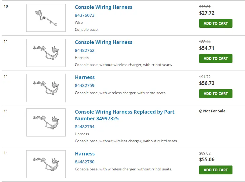

See the below Wiring Harnesses,  Mine has finally shipped, seemed have been detail for about 3 weeks.
Did you ever get this to work with one of these harnesses? I did the swap 18 months ago, but finally decided to try and get the 12v and USB’s to work for the kids in the backseat.
I got side tracked and have not tried it yet.  I need to trace the existing cable to confirm the connector.
