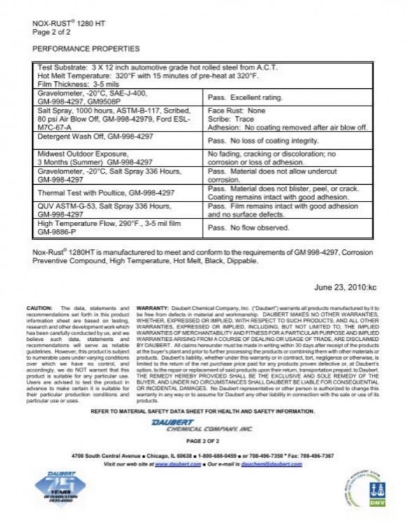

6ACFAAC5-DB9C-46C8-BE59-C873AFBDF25A.thumb.jpeg.3312a539fd4ed5ca293a7287a9497274.jpeg095E4D55-F948-4F0D-BB31-9F885A4CB4E2.thumb.jpeg.7f7ad144cd4104b2b5ea5be552b9f4ef.jpeg
“Manufactured to meet and conform the the requirements of GM 998-4297, corrosion preventative compound, high temperature, hot melt, black, dippable.”
No, I don’t have a sworn affidavit from Mary Barra that it’s the only product they use. But it’s easy enough to read the tea leaves or I wouldn’t have made the statement I did. Why else would Daubert be producing a hot dip product designed specifically to meet GM standards?
Stop with your guessing there is other products that meet the criteria we had several different spray cans at the dealership that we used on peeling frames, its tough for you I get it.
