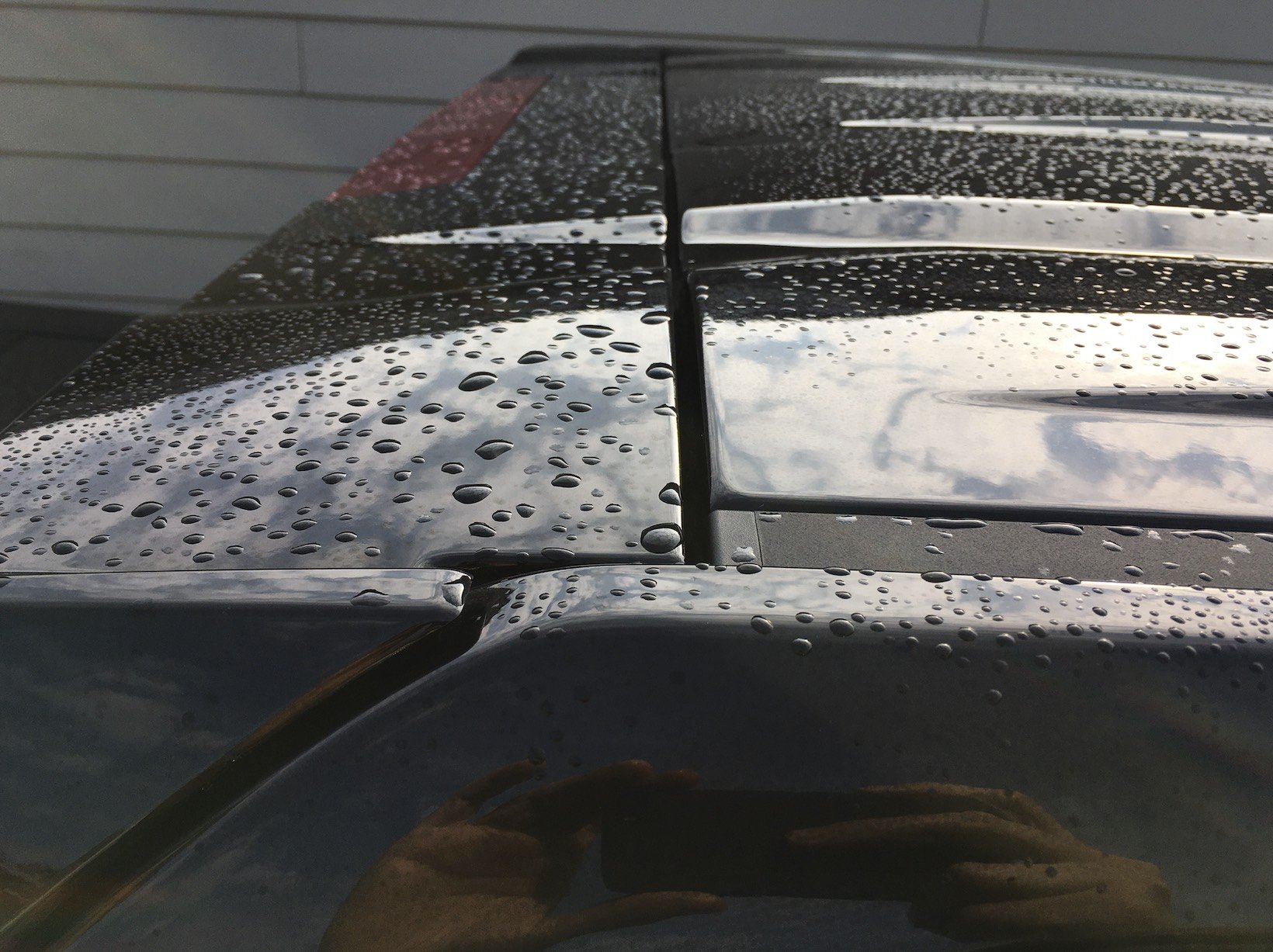

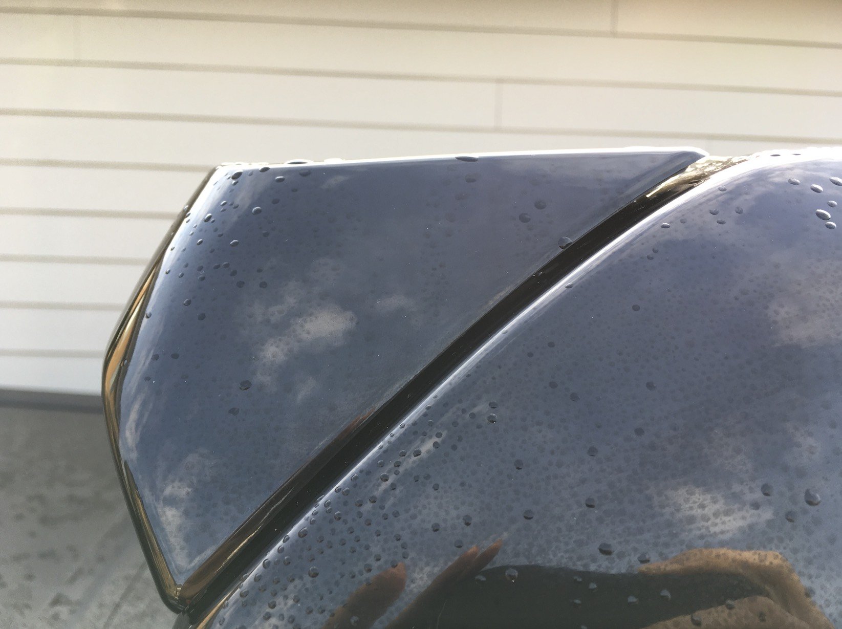

It is a giant piece of plastic bolted to a giant piece of medal
They expand and contact at different rates
And it is bolted it isn’t taped or glued or put on with trim clips
I like it that way. maybe his has come loose?
how does one access those fasteners?
You gotta drop the headliner...

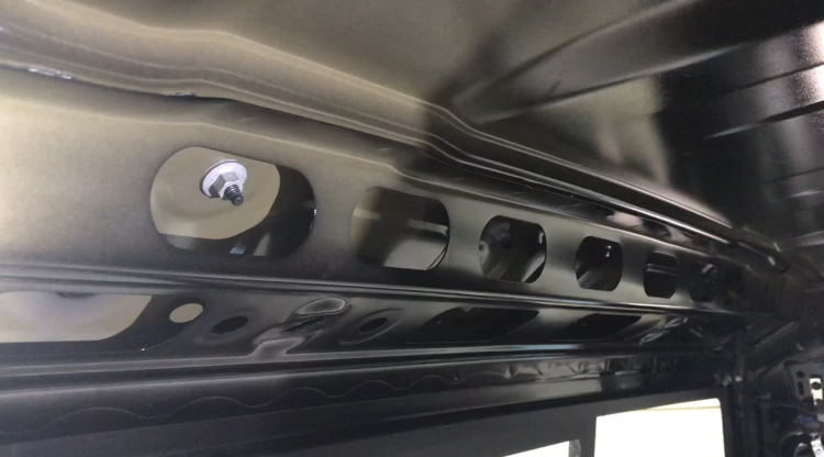

I dropped my headliner to fix my rear window leak.  No loose fasteners.  No matter how I tried to mount the spoiler back on it was a bit off.  So I guess that's just how it is.
