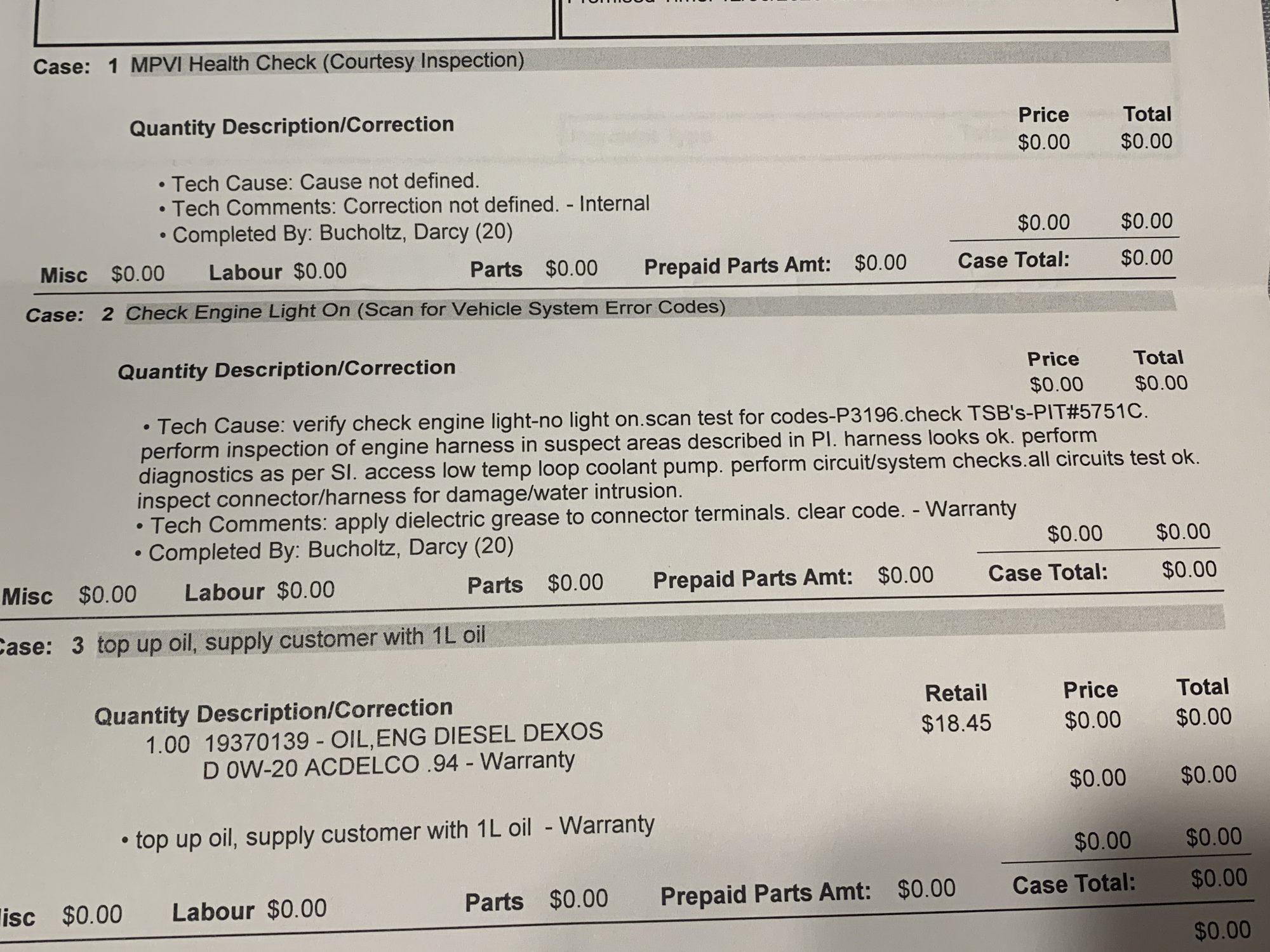

Dealer got back to me and said the same, the cooling system on the turbo wasn’t cooling as required and could be the pump. Booked in to be looked at. Weird!!

Dealer had this to say? Check engine light went out on its own on its way to the dealer, does this mean there’s a TSB? Can someone look it up?
