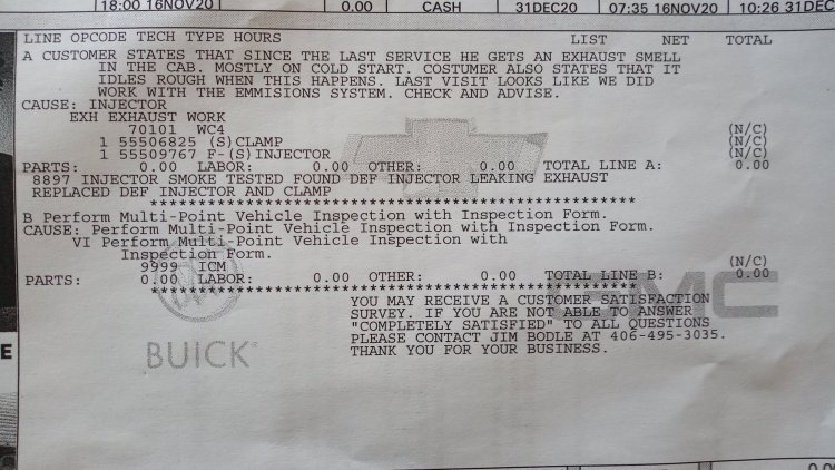

This is a known problem.  I had mine in for the exact same problem with exhaust smell in the cab. Only when cold a few seconds after startup.  The dealer did a leak test on the exhaust and diagnosed it as a bad def injector and clamp.  It took a month to get the parts on backorder.  Just had mine finally fixed last Friday.  I would press the dealer on this problem.  It is not good to be breathing exhaust and carbon monoxide in the cab.  Now, getting a burning smell around the time the engine does a def regeneration is normal, especially for the first few thousand miles.  However, the exhaust smell at cold startup is definitely not the def regeneration.

@Kchampagne would you be able to take a picture of your work order that describes what your dealer did to diagnose and fix the issue? I want to be armed with as much information as possible when I drop my truck off at the dealer. Thank you!

Here you go.
@Kchampagne Thank you for the repair order info. I have a 2021 GMC 1500 with 600 miles. And, I just called my dealership last week about the diesel exhaust smell in the cab during cold startups.
The part numbers for the def injector and clamp are listed on the invoice. The dealer said the main culprit is the clamp, but replaced both.  Just FYI, I did not have the exhaust smell (for 9,000 miles) until the dealer replaced a bad def injector.  I had to bring it back a second time and they replaced the injector and clamp again.  This took over 3 months. The def injector and clamps are in short supply nationwide.  Fingers crossed, it seems to be gone.
