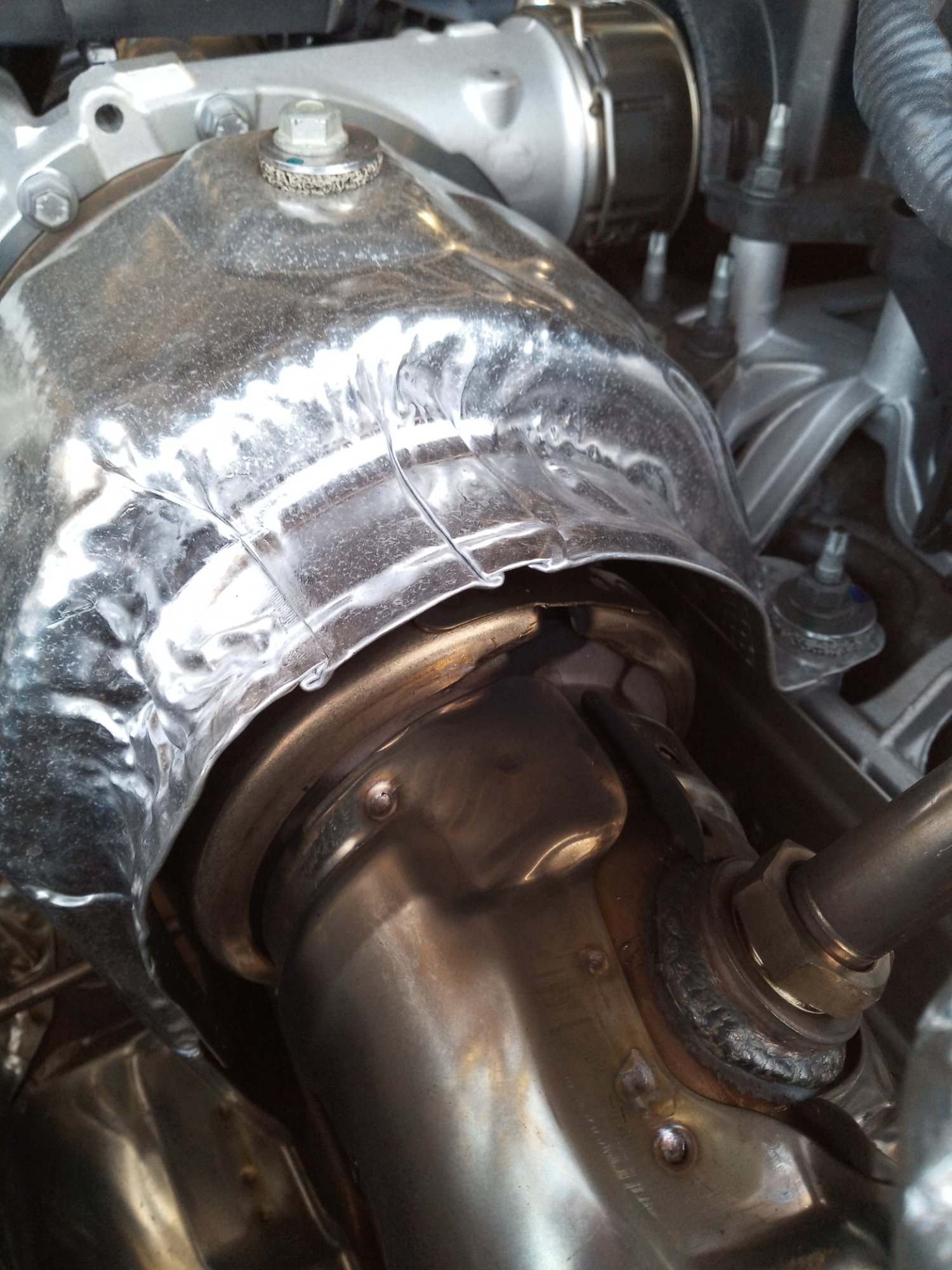

On 5/11/2022 at 3:53 PM, PrairieRifle said:
Got a brand new 2022 Yukon XL with 3.0. Thought I smelled diesel fumes at the dealer but brushed it off, because hey I'm a farmer.  Wife cried when I brought it home and said she couldn't handle the smell.   Needless to say it became even more apparent there was an exhaust leak in the engine compartment which would end up also stinking up the cab.   Read this entire forum and it was not the exhaust check valve or the clamp on the bottom that have been listed on this thread.  I located the leak at a clamp directly in front of the turbo.  It was literally puffing out exhaust and there was soot by the clamp.  Took it to the dealer who put on the new clamp and new gasket and they said it didn't work and we don't know what to do to fix it and they would have to call GM. I then decided to look at my friend's 2020 Sierra with a 3.0 which revealed the problem.  The clamp has a metal strap that holds the two halves together.  When you tighten it up it cinches the clamp tight which pulled the two pipes together.  My factory clamp was welded together with a very large gap(about half an inch) between the two pieces while my friend's  clamp was welded with the two pieces almost touching.  This made it almost impossible for my clamp to effectively create a good seal between the front of the turbo and the exhaust pipe it is clamped to.  I got desperate when no one could or would help me so I took it home, removed heat shield, took the clamp off, drilled out the two spot welds on one side of the clamp and rewelded that same side with the two halves of the clamp almost touching.  I then loosened the brackets on the part of the exhaust pipe that went farther down into the engine compartment so that the clamp would be able to effectively cinch up without being restricted by the brackets. I then reinstalled the clamp and leak tested it with soapy water.  Voila!  No leak. I then retightened the brackets and put it all together and leak tested with soapy water again.  Still good!  The shocking part was even the replacement clamp from GM was manufactured incorrectly with too big of a gap.  Which is why the GM service dept couldn't get it fixed. I'm sure they didn't try too hard anyway.  I will include pictures as it was with a large gap when it leaked exhaust and i will also include pic of my fix.  It's not perfect and doesn't look beautiful but at least it doesn't stink anymore.  Shouldn't have to do this with brand new vehicles but that's just America today.....    Best of luck to all.
That's a pretty awesome fix you did there !
I had the issue and mine ended up being the backpressure valve - there was a bulletin on it and I swapped mine out. No more smell. (i'm a tech at a dealer, so I did it myself.)

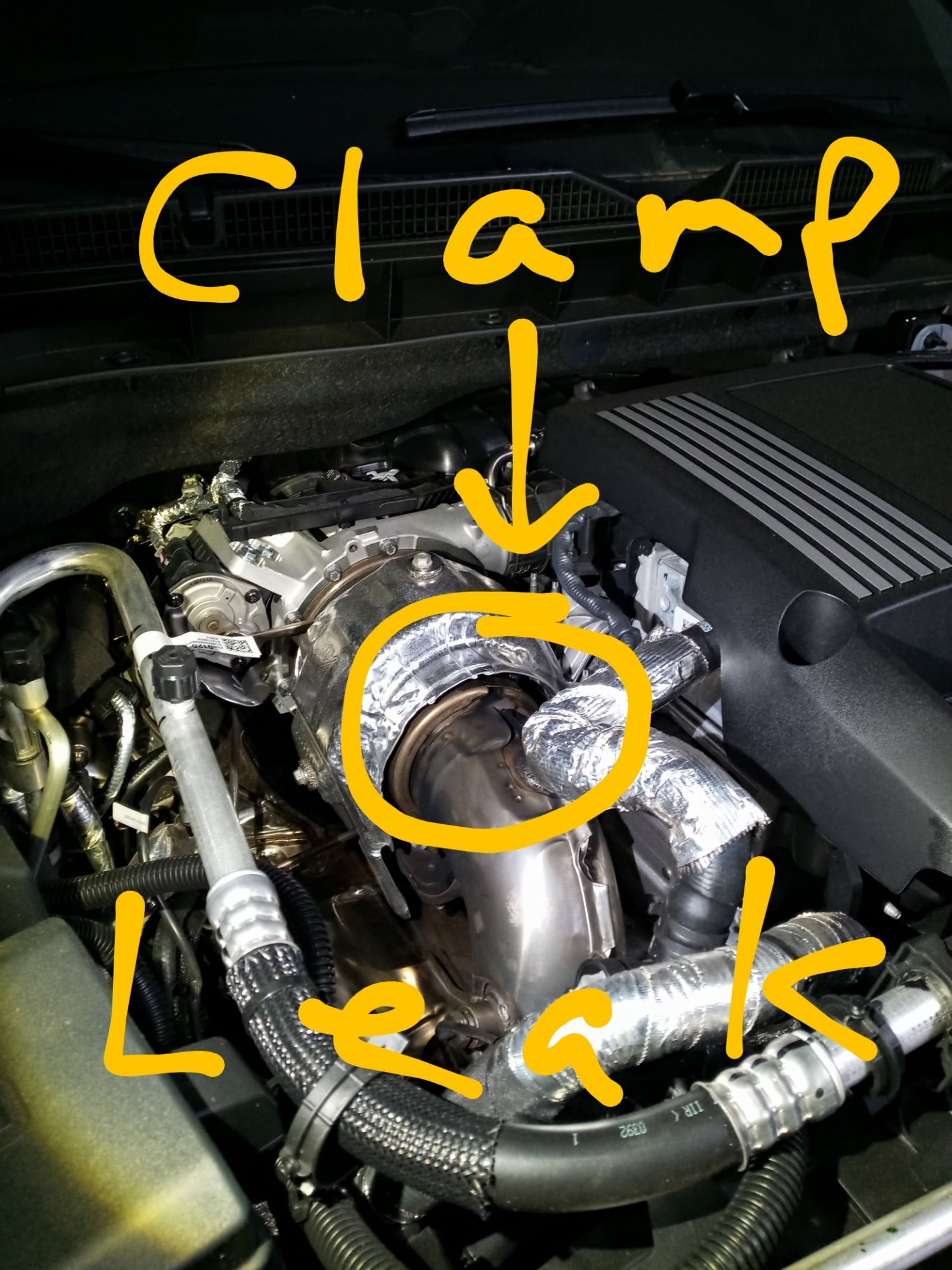

The dealer was able to loosen brackets down through the exhaust system and then realign the cat pipe (down pipe?) with the turbo. They put a new clamp on it. They performed an exhaust leak pressure test and it seems to be repaired now. Just wanted to provide an update. It took them a couple of days to accomplish the repair and they gave me a 2019 Ford Expedition Max as a loaner. The expedition had some get up and go with that ecoburst motor but the steering and ride and overall plastic interior was not my cup of tea. It was nice to get back into our new Yukon.

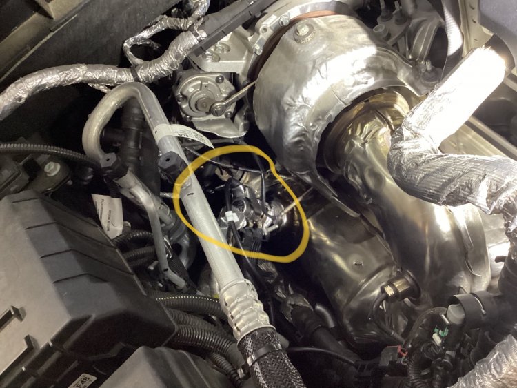

Renductant Fluid Injector not sealing off at NOX Catalytic Converter seal causing exhaust fumes to enter cab.
Corrected by Emission Reduction Fluid Injector Replacement.
part # 55515114 Injector
part # 55506825 Clamp
Found by using smoke test.  See image!

They replaced the clamp that connects the turbo to the downpipe however when we were in colder weather 20s to 30sF° and snowing I noticed the smell of diesel fuel and diesel exhaust. On some days I swear I can still smell the exhaust in the cab even when it's in the 50s and 60s. I've checked the downpipe and can't tell that there's any leak there so maybe it's leaking somewhere else? Not sure why I'd be smelling diesel fuel. When they replaced the downpipe clamp they claimed on the notes that they performed an exhaust leak test and it checked out but now I'm not sure. Maybe something else worked it's way loose? Will be reporting at the next oil change in April/May.
If i were you I would wait until your engine is cold. Take off that little safety shield above the turbo vclamp they replaced and have then have spray bottle of soapy water there.  Start the engine and spray the soapy water all around that clamp to make sure it is fully sealed.  If there is a leak bubbles will start appearing. Even after I fixed, replaced, and realigned my clamp i checked it that way and had to retighten the clamp before i got a complete seal.  Even if you dont attempt the fix yourself which most people will not, at least you'd know of there is still a leak there. There are also some clamps farther down in the exhaust system that have been shown to leak also.  Wish you the
