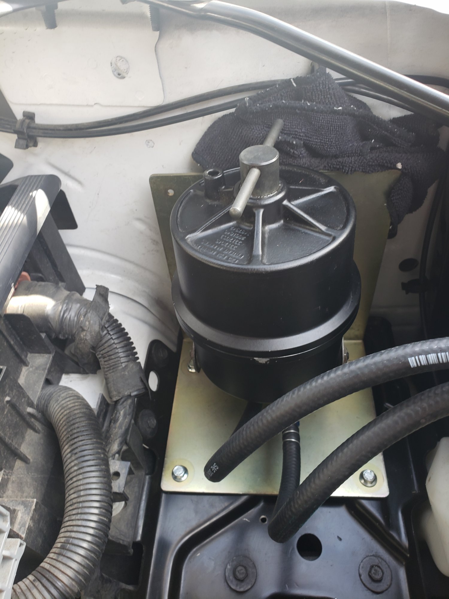

flyingfool Posted January 15, 2021 Posted January 15, 2021 (edited) if you did the bypass mod, you can bring the temps up about 10-20 degrees by installing a full flow spin on filter without the anti drainback spin on oil filter. this puts pressure on the cooling line and and holds back the trans fluid from flowing freely thru the cooler. i found a standard spin on filter with the anti drain back valve causes restriction and will increase the trans temp to the same level as the thermostat before deleting it. I now got rid of my old spin on set up and went with a motorguard cartridge style (toilet paper roll) design, more surface area and no restrictions with drain back valves, also dialed down the trans fans to 190 degrees operation , before they never turned on until 220 degrees. Edited January 15, 2021 by flyingfool

Tie Posted January 15, 2021 Author Posted January 15, 2021 10 hours ago, flyingfool said: if you did the bypass mod, you can bring the temps up about 10-20 degrees by installing a full flow spin on filter without the anti drainback spin on oil filter. this puts pressure on the cooling line and and holds back the trans fluid from flowing freely thru the cooler. i found a standard spin on filter with the anti drain back valve causes restriction and will increase the trans temp to the same level as the thermostat before deleting it. I now got rid of my old spin on set up and went with a motorguard cartridge style (toilet paper roll) design, more surface area and no restrictions with drain back valves, also dialed down the trans fans to 190 degrees operation , before they never turned on until 220 degrees. Hi flying Can you send a link I can see parts or video installation to understand more. Thanks
