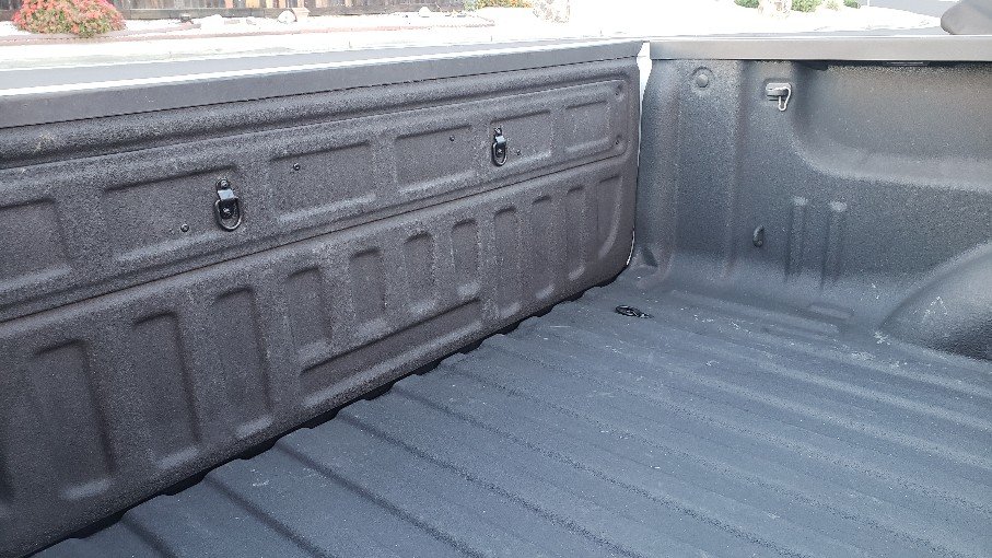

Ravenkeeper Posted February 9, 2021 Share Posted February 9, 2021 Looking at the front three tie down holes in the front of the bed, and not being able to tie my cargo net ANYWHERE along the back/tailgate, made me wonder if anyone has installed aftermarket tie downs to their tailgate. Has anyone done this? What did you use? Quote Link to comment Share on other sites More sharing options...

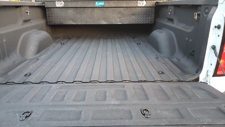

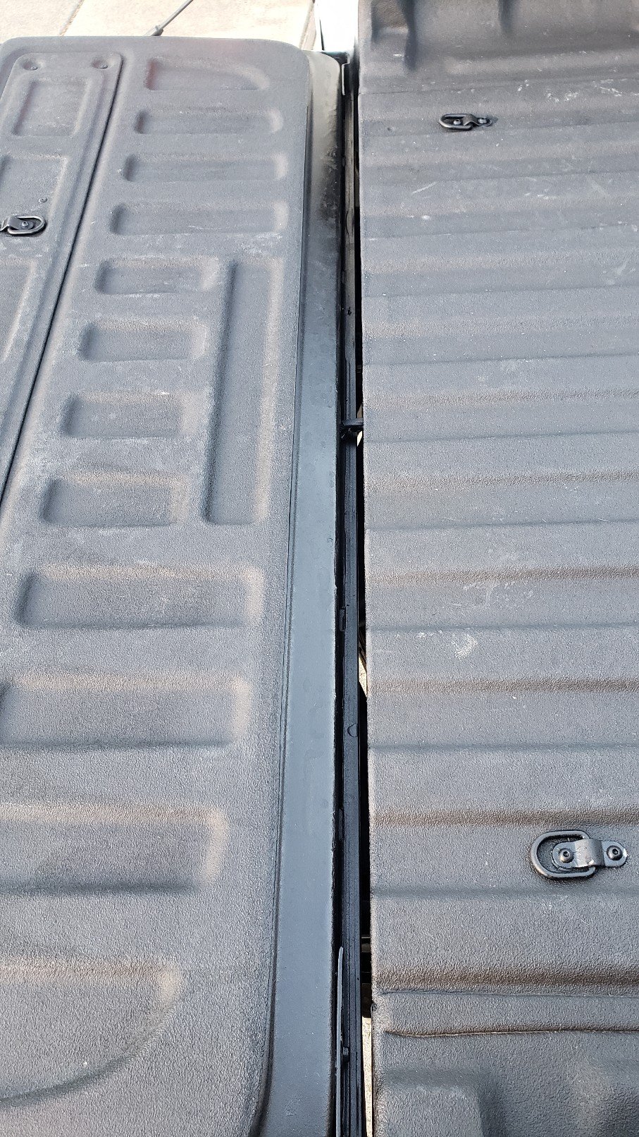

jaimeastin Posted February 9, 2021 Share Posted February 9, 2021 I did. It's a very practical mod. Cargo nets and tarps can now be put on all around. Laying down the gate to care thing alike my kayak has a more security. My truck is not a junk truck, but I use it like a truck. No mall crawling here. I added some hooks to my bed as well. I also have a couple that line up directly on my took box. The hooks on the gate and tool box are not for heavy loads due to install location. The ones on the bed, I used for heavier loads. I still like the stock corner for the heaviest of loads. More so what you are looking for, they got the bill. Nothing aftermarket. I just installed some stainless steel "D-Rings" and used all stainless hardware. I painted them with bedliner, but you see that came off with usage. 1 Quote Link to comment Share on other sites More sharing options...
johnnychuttz Posted February 9, 2021 Share Posted February 9, 2021 (edited) I threw these in the 9 holes in the bed. None have failed or come loose. https://www.amazon.com/Anchors-2007-2018-Silverdo-2015-2018-Colorado/dp/B07MB97SVQ/ref=sr_1_26?dchild=1&keywords=CHEVY+SILVERADO+BED+TIE+DOWN&qid=1612896496&sr=8-26 Edited February 9, 2021 by johnnychuttz 1 Quote Link to comment Share on other sites More sharing options...
