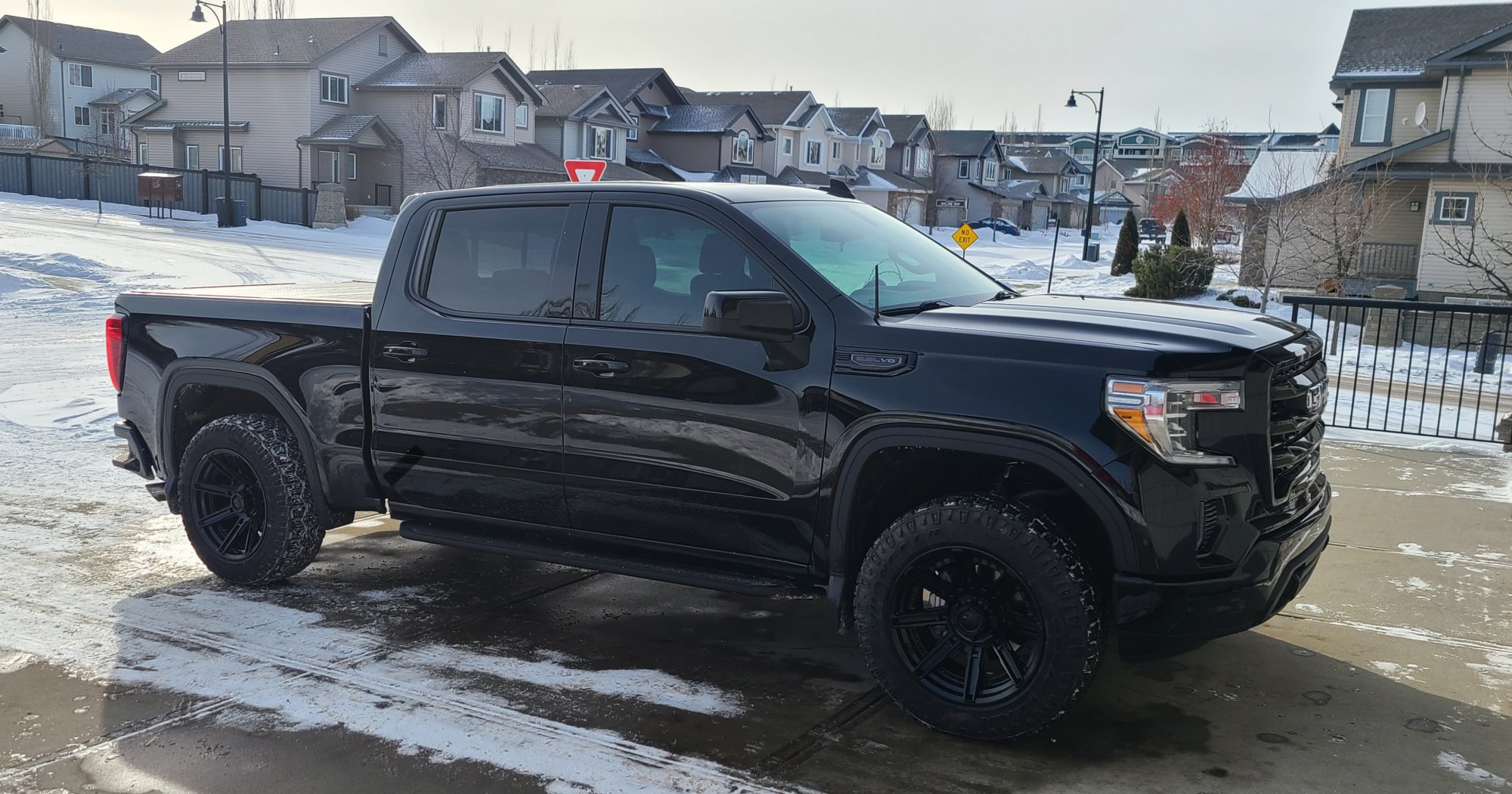

I have Bilsteins on all 4 corners. This is mine set at the 2.5 height in the front. Prior to the Bilsteins, I had a 2 inch under strut Readylift spacer with stock shocks. The Bilsteins are a much better ride.
I've never ran them at the 2 inch setting, but I've heard that its a bit more forgiving. I went with the full 2.5 because I've read from a couple people that the 2 inch setting doesn't quite get you a full 2 inches. If you are worried about the ride, you could always keep the shocks at stock height and run a top spacer.
Stock was too floaty and was terrible at recovering from large bumps. Under strut spacer + stock shocks were a bit stiff. Bllsteins at top setting feel great to me ?
