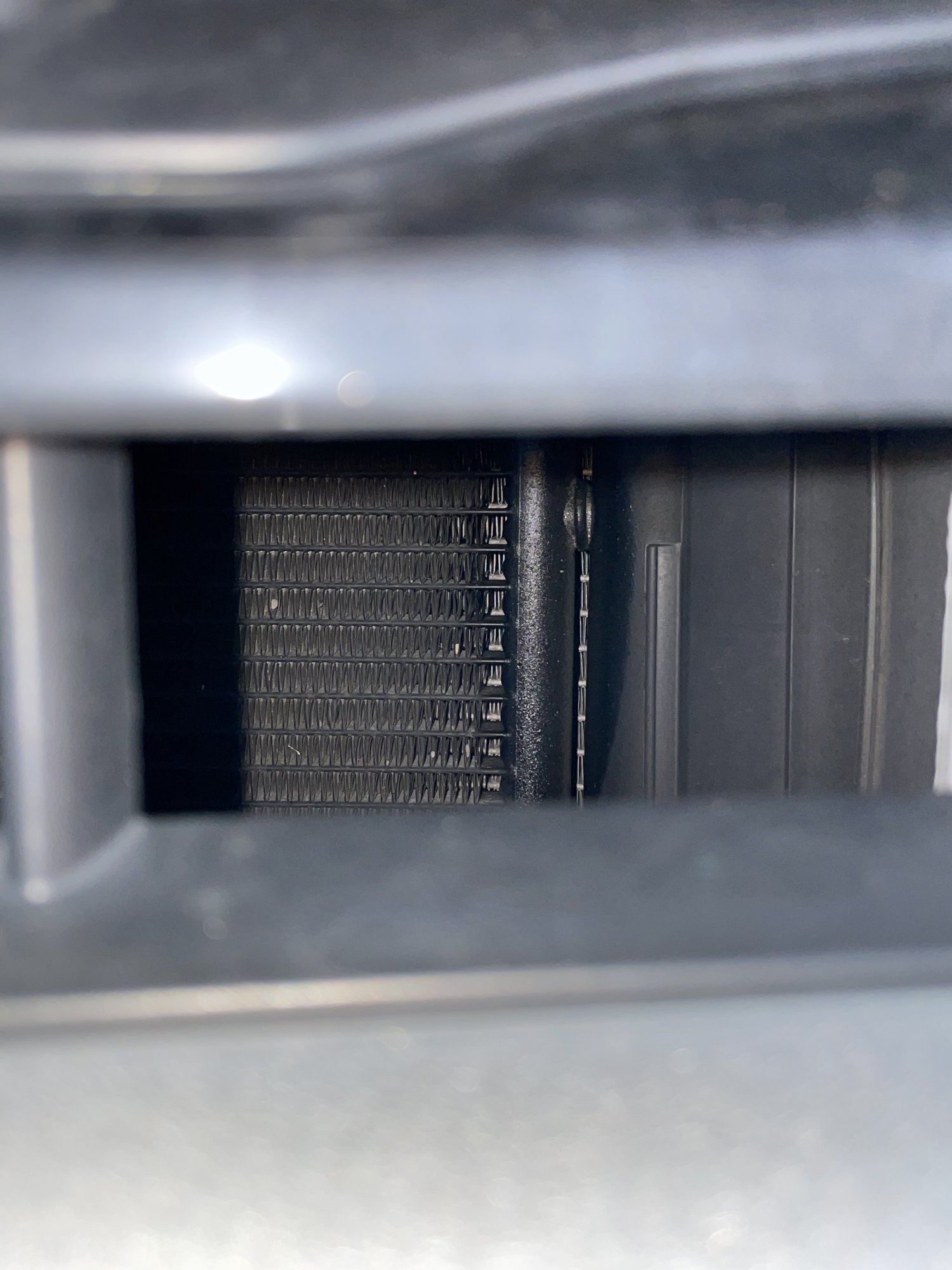

The 14s and 15s were notorious for the condenser leaking. Not sure about the 16s and up. Try looking through the grill on the driver's side and maybe even the passenger side and seeing if there's a wet spot on the side of the condenser where the weld is. Usually a slow leak but you'll see a wet spot. Mine would take 2-3 weeks to leak down

The condenser is probably leaking. I just had mine replaced.

Bingo, pretty well known problem with the K2's, the "hot AC" being the biggest sign that the condenser has failed/leaking.
Might check with another shop for repairs, if yours did not bother to even check for this.

That's what mine looked like. The new one has a piece of foil there now
