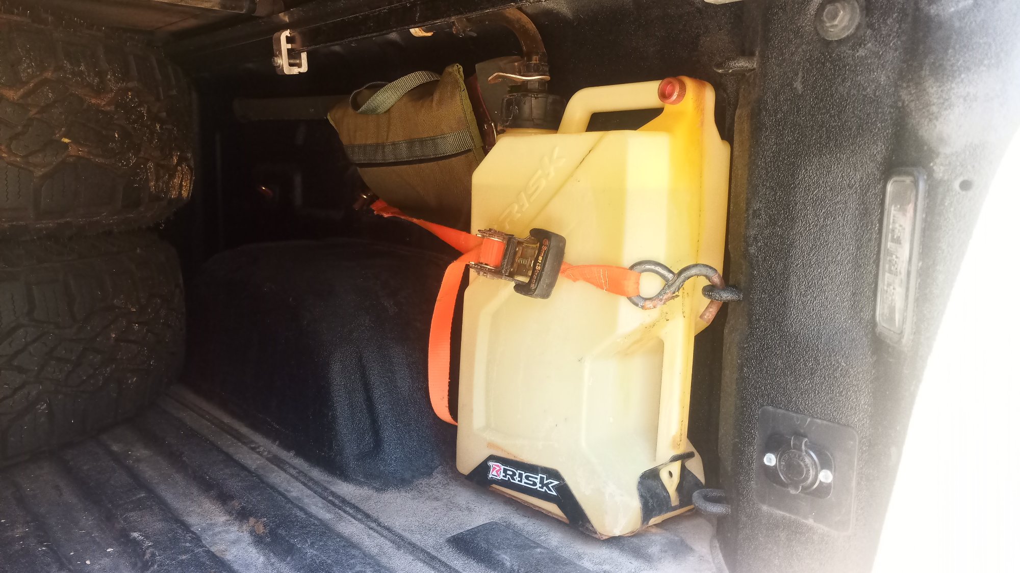

As we all know our trucks only hold 24 gallons of fuel and that can lead some range anxiety, especially when venturing into unknown territory. As a safeguard I bought a 3.5gal Risk Racing fuel can and mounted it in the rear bedside pocket with a strap. It fits perfectly and doesn't interfere with loading other items in the bed.

I have something similar planned.  I'm going with the Valhalla Offroad MOLLE side panels and mounting Rotopack fuel cans in that area.  Definitely agree with fuel range concerns when offroad, but what vehicle owner isn't?

You will only be able to fit 1 gallon cans on the panels

Already tried and failed with a 2 gal rotopax.  You will have to use 1.75 gal or smaller rotopax because the 2 gal wont fit with the MAPS panels unless you use multiple mount extensions and it sticks out into the bed waaaay to far.  Rotopax also has the cylindrical tubing canisters that would fit but they are stupid a$$ expensive.

The bolded part smells like hope, and I haven't even tried yet.  Thanks for the insight.

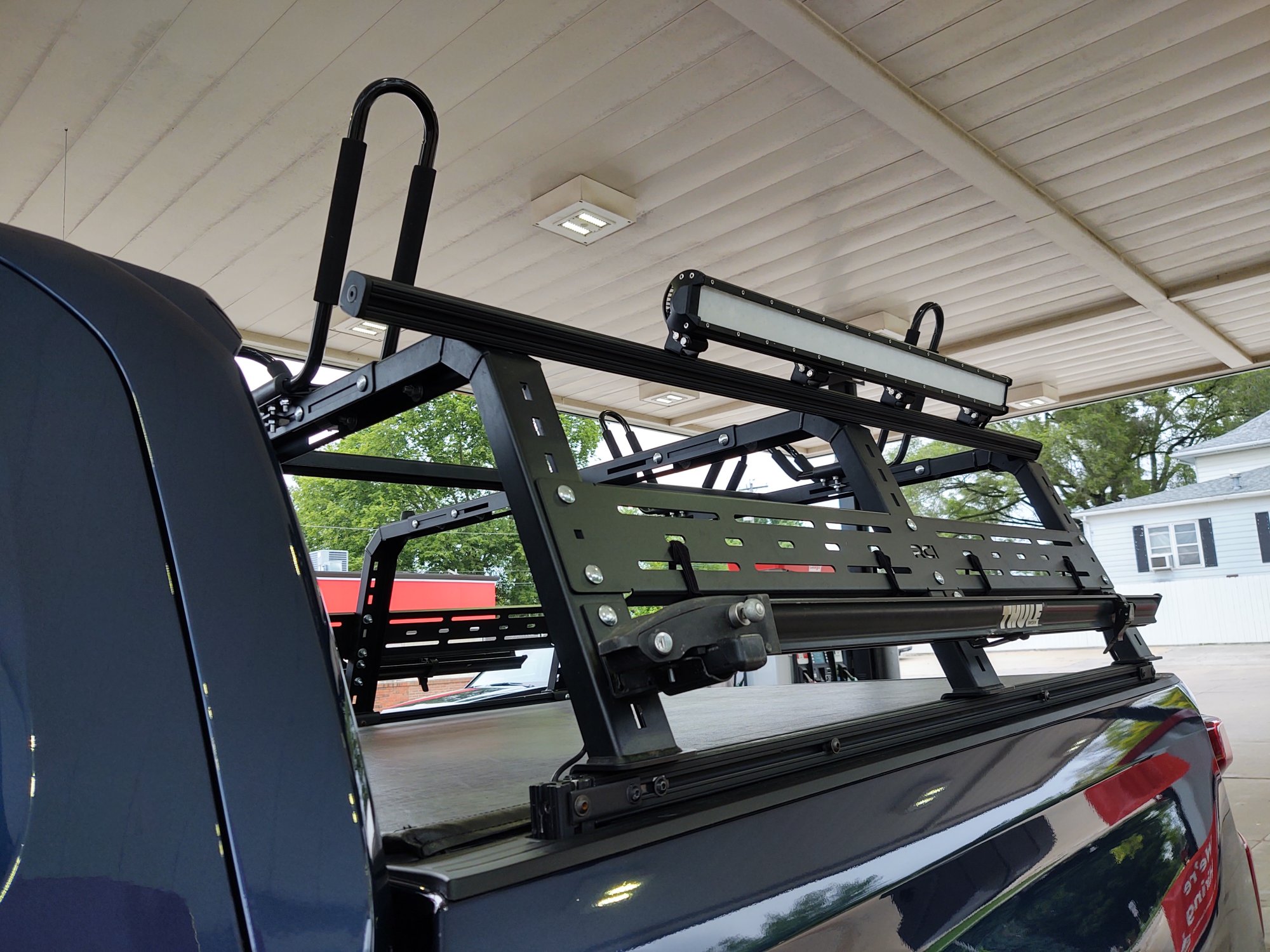

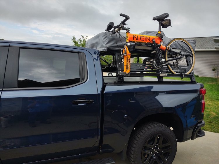

Hey Guys! I was excited to see this thread. I had a camper I pulled behind my offroad rig and decided to downsize a bit. This is what I have so far. I pull the tent off so I can mount my Kayaks on top. In the future they will be mounted inside the rack with the tent on top while being able to see out the middle back window.

What's running through the rubber hose that is mounted upwards, and to the right, of the interior bed light?
It's an power cord for my LED bar and then later an AC unit for the window of my RTT. That extruded aluminum is nice to work with and very sturdy when mounted correctly. I added tape to the led as a type of diffuser.

Not enough dirt.  I can still see the truck in the picture.
That’s the first day, I think the second day might have enough dirt but haven’t looked at those photos yet haha
