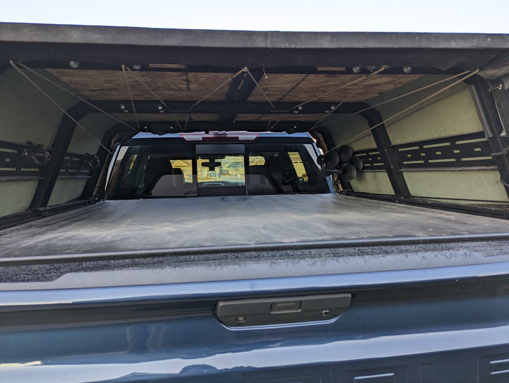

I added a canvas to keep the snow off the tonneau cover. I think I might keep it on for good. I added plywood on top for a shooting platform.
Then some ditch lights and train horns to make it mine.

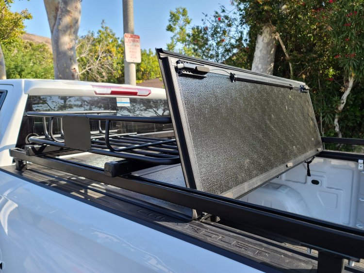

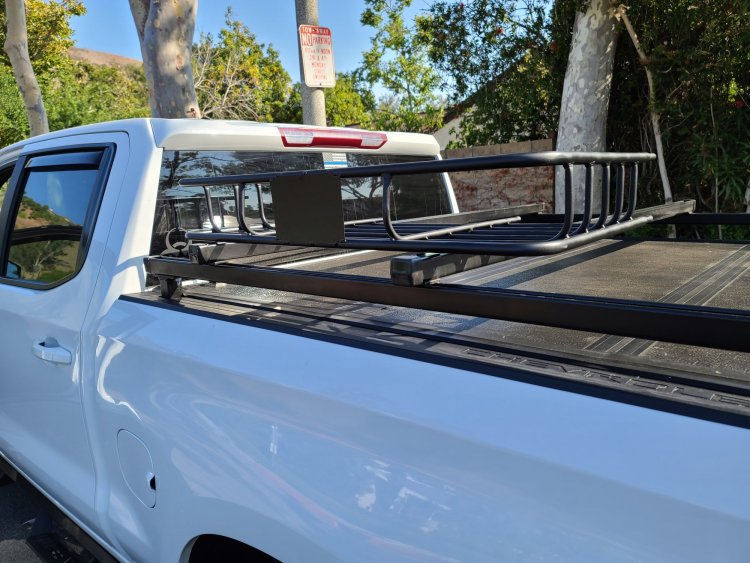

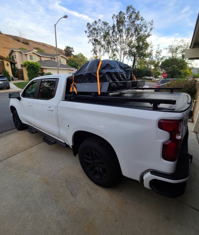

Had a folding tonneau and wanted to keep the sealed aspect of it, but didn't want to spend tons for a rack/ cover system that was compatible. Saw that my stake pockets were out of the sealed zone, so built a frame using uni-strut that I got free from work. Allows me to still open the folding cover if needed for access, but keeps everything underneath dry/locked while expanding storage. Loaded up with a waterproof bag and worked perfectly. Keeps close to roofline to keep gas mileage.

Went from southern California to Montana, Wyoming, Colorado. Average 28mpg going up mountains fully loaded with 2 adults, a child, and all camping gear.
