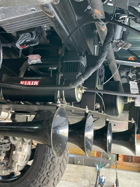

If anyone is interested in a more compact "Train Horn" kit that can all fit under the hood pretty easily, this one works.  I was able to install the whole shebang into the secondary battery location.
It's the Vixen Model # VXO8805/3118.  I purchased on Amazon.  The biggest difference between this kit and most is the tank is only 1/2 gallon in size.  You still get about 4 seconds or so, which is plenty!  The compressor can recover a completely empty tank in 45 seconds.
While this doesn't sound exactly like a train, it's plenty deep and loud.  It's not gonna blow your neighbor's windows out, but it is quite a bit louder than the factory horns.  The kit comes with everything you need, except a relay (you really should use one to switch the compressor).  I also installed some switches in the dash.  One powers the compressor which in turn arms the horn button.  If anyone wants any more details let me know.  Here are the pics!

I went the full route - mounted using spare tire delete package.  I like it, already used the compressor a few times camping.  The horn is extremely loud though as you mentioned if you don't like that.  Of course a true train horn is also very loud

i Managed to get my entire train horn kit into the engine bay with the exception of 1 horn. there was enough room inside the fender to get the 3 smaller ones, and the large i mounted sideways just above the front air dam.
the compressor and tank mount to the side rail of the truck, you can barely see it from the outside.

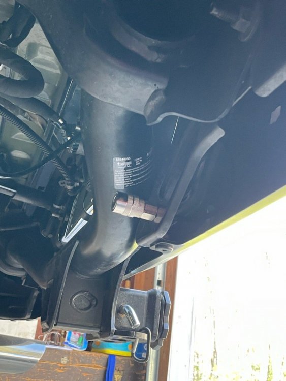

I have a Nathan K5La REAL train horn on my 2012 Tahoe with a 5 gal tank. I've had this horn for over 16 years. Since I'm selling the Tahoe, I'll be installing the horn on my 2020 silverado. My question is where would be an ideal place to mount each bell? I have them each on their own mounting bracket (5 horns). I'm sure the air tank will go where the spare tire is currently at same as the Tahoe, Buyt I'm not seeing a lot of room under the hood to install the compressor. I don't want it exposed to the elements as the intake can also suck in moisture from the air which will cause the compressor to fail.
