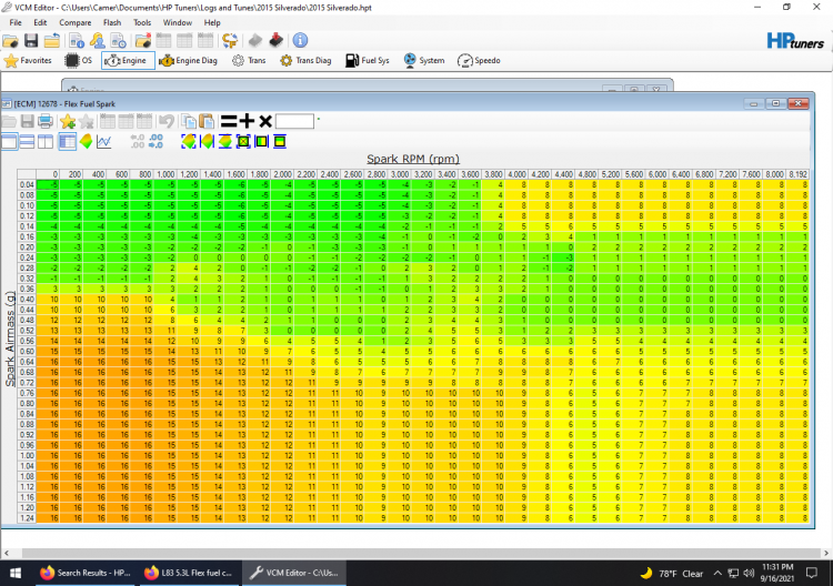

It's really quite simple - @Grumpy Bear doesn't get deep enough into the load range to notice the difference that the extra ignition advance adds. Here's a paste of a stock Flex Fuel timing table. This adds (or subtracts) based on another multiplier which references alcohol content.
Something else worth mentioning is knock learn factor. Allow me to explain. If you've been running 87 then your ECM will have certainly "learned" to run less ignition timing because it detects knock at higher loads at various RPMs. Basically, if the ECM detects greater than 3* (on my L86) of knock then it will interpolate between the high and low octane spark table to find a value that doesn't knock. If you randomly fill up with premium then it will slowly realize that there isn't any knock present and start learning back to the high octane table.
Why do I bring that up? If you run ethanol for several consecutive tanks you are allowing the ECM to bring back ALL the ignition timing that it's been removing (assuming 87 octane) PLUS it will be adding more timing in the higher load ranges. This extra timing should make a big difference in the way it feels in top gear lugging around.

Nope. The flex fuel table only adds (or subtracts) from the current "learned" amount of timing it's running. While I don't fully understand how "knock learn down" function works the values prepopulated in HPTuners looks like it would take a hot minute.

I am glad someone point out, there are more than just the 2 timing tables used when on E85. You have the high/low table for gas, the high/low table for gas when DOD is active, you have the main adder table for E85 and then the modifier table for the composition of E85 that the ECM is seeing from the Ethanol sensor.
The E85 main table adds to the main gas table and then based on the E85 percentage composition reported then uses the modifier to determine how much of the E85 main timing added is used. So if the E85 main timing table is calling for an additional 5° of timing and the Ethanol sensor is reporting E70 then the composition modifier table references the percentage of timing adder allowed (say 50% for this example, but it is a sliding scale) and adds 2.5° of additional timing to the main timing table for gas.
You can log all of the timing PID's in the HP Tuners scanner app and see exactly where the ECM is adding or subtracting timing from at any time.

On page one I posted a picture of a 2015 5.3 files high octane timing and the flex fuel spark adder. If we go by that picture the timing allowed is only going to be around 18-20ish and then it uses all of it's adders to get it higher. Like a gas spark adder, IAT, ECT and VVT will all add timing. It's hard to give an exact answer on what the max allowed timing is because it can change from cell to cell in the timing tables. You seeing mid to upper 20's surely does seem possible though.
