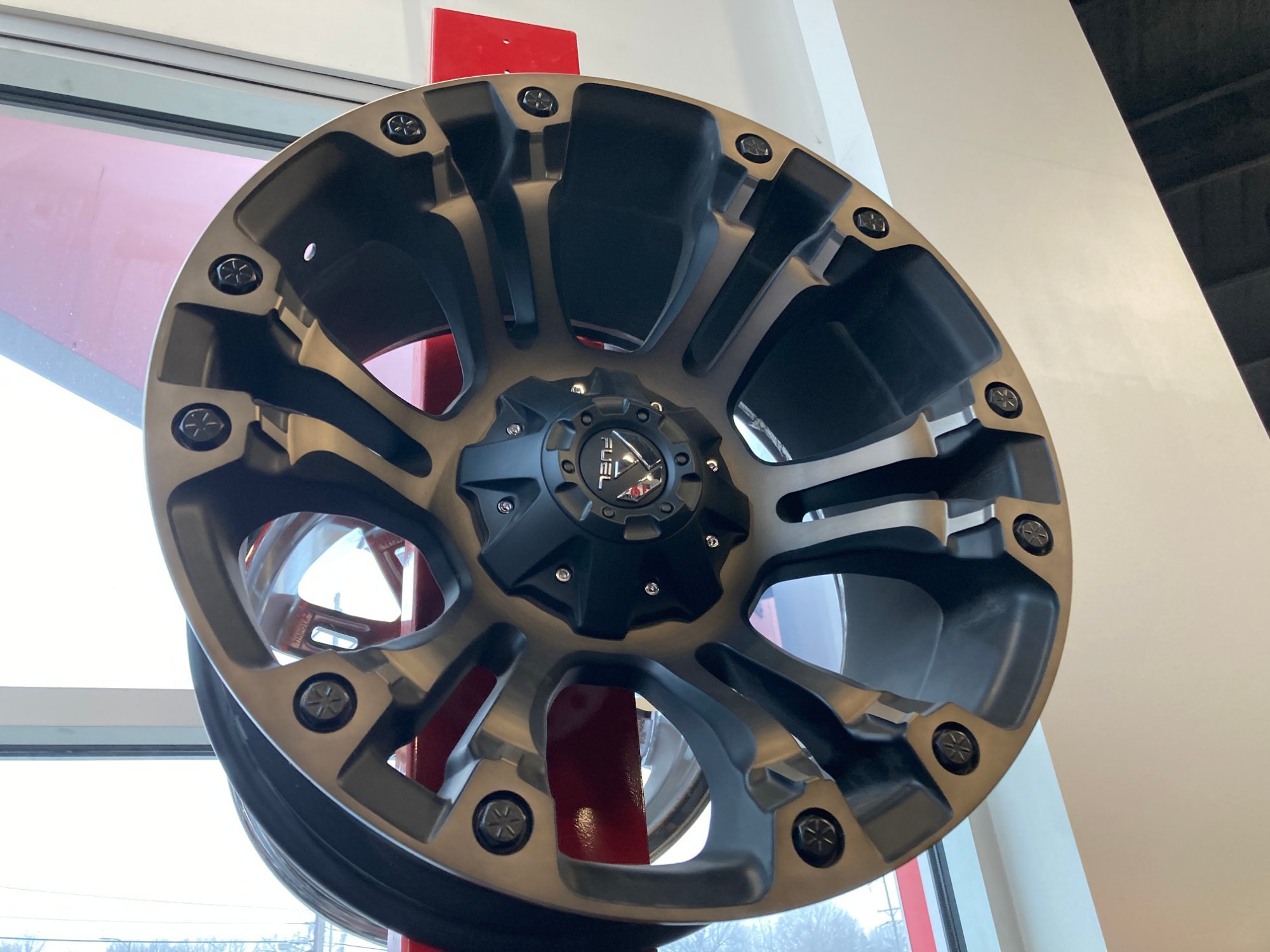

Sowens1959 Posted January 14, 2022 Author Posted January 14, 2022 Thanks for the input, I'm changing out the wheels as well to FUEL 20"/10"/ -18

Luster Posted January 26, 2022 Posted January 26, 2022 On 1/14/2022 at 8:24 AM, Sowens1959 said: Thanks for the input, I'm changing out the wheels as well to FUEL 20"/10"/ -18 Your stock wheels are +24 offset, these are -18. That's a total difference of 42mm (1.65" outboard), Yes, your larger tires will rub and you'll have to trim the back of the fender liner. I have a 3.75" lift and my 285-65-20's rubbed badly with a -44 offset. Pretty major trimming of fender liner.
