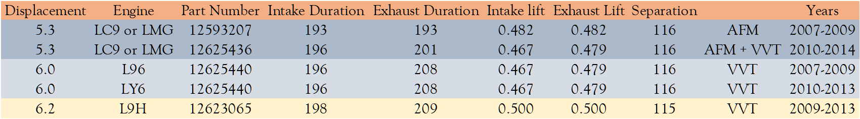

My pleasure sir!  In the chart above, the second listing is your stock camshaft.  The camshafts under yours are of course a little larger but allow you to retain VVT.  If you wish to delete VVT, the L33 Camshaft used in the Generation 3 engines would be the way to go, it's grind is identical to the top listing without AFM, it's part number is 12583623.

You'd have to run a 4.8 or 6.0 camshaft is just wanted to keep VVT.
Or switch to a non AFM/VVT camshaft, buy a new cam gear and swap to a non VVT front cover.

So what did you decide to do?  In selecting a factory stock camshaft with VVT, I would go with the L9H camshaft.
