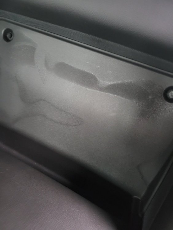

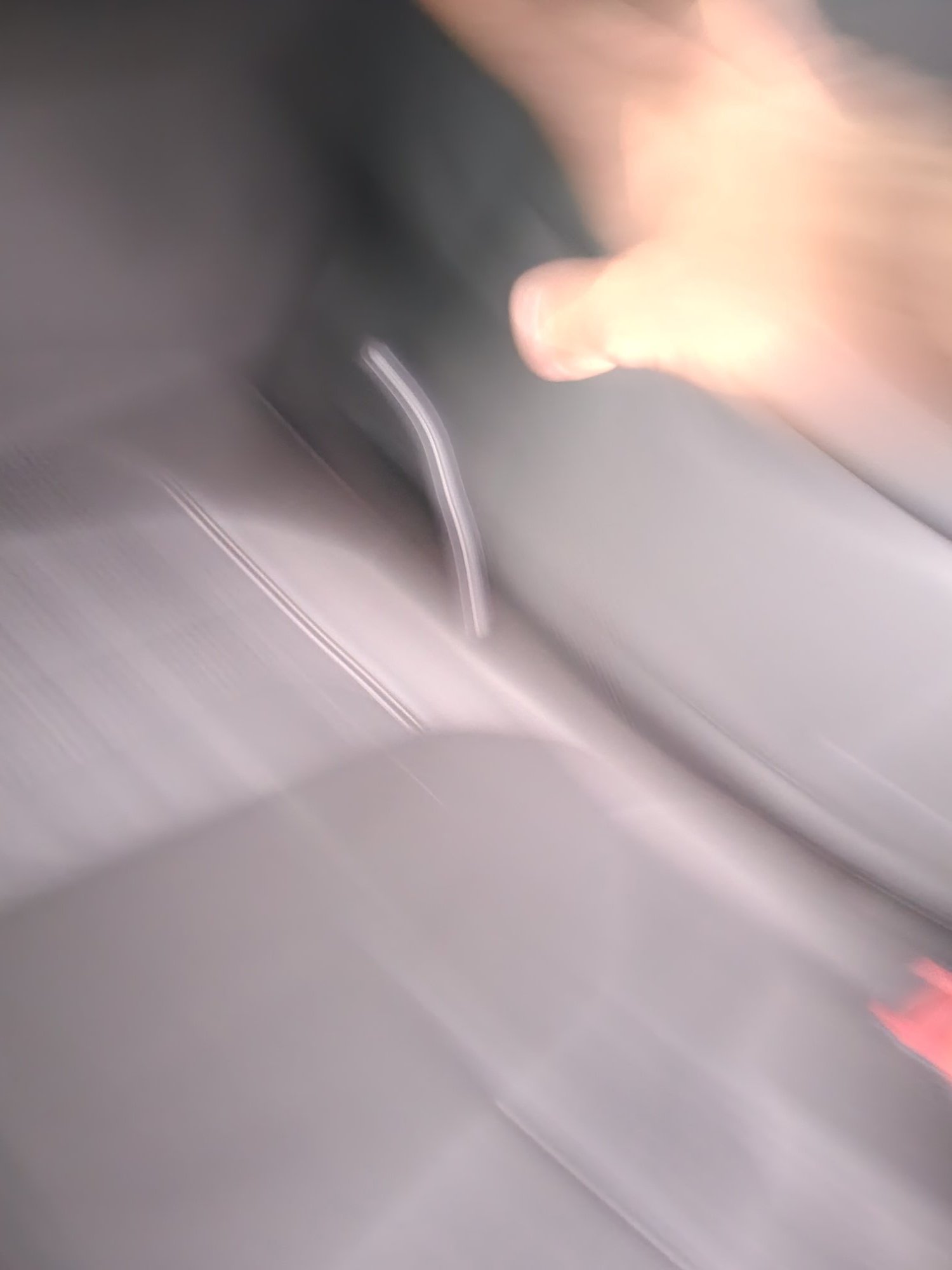

See my previous post if able. A few weeks ago, I almost bought a 2019 silverado, but noticed there was moisture in the rear storage compartments.  They said it was fixed, just got back from service today...but this is what I see.  This can't be normal. Thoughts???
I'm guessing that if in fact that they repaired the window either as most dealers do they didn't get it sealed or your carpet is still damp.
Run a dehumidifier in the truck for a few hours to remove all the moisture, then see if it continues.
Part of me says that that can be normal as well if you live in a cold climate. There are no vent or airflow that reach that back wall. So if the trucks is very cold from sitting and you operate the truck for a while, that compartment is still blocked off from the warm air and will take a long while to fully warm up. So condensation build up seems likely.
