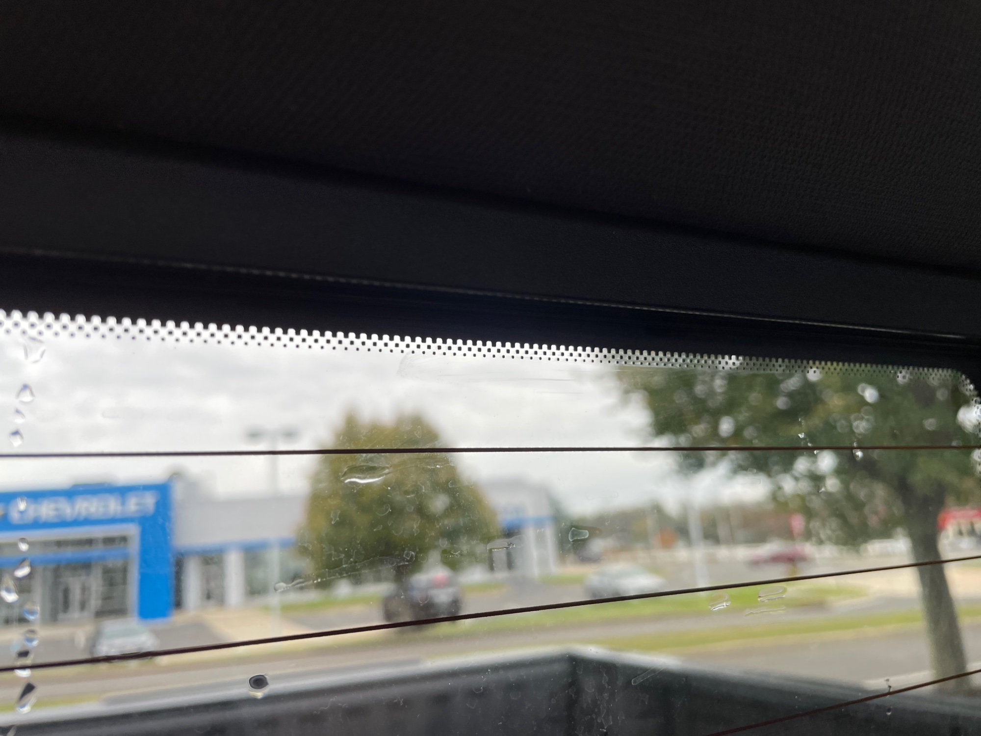

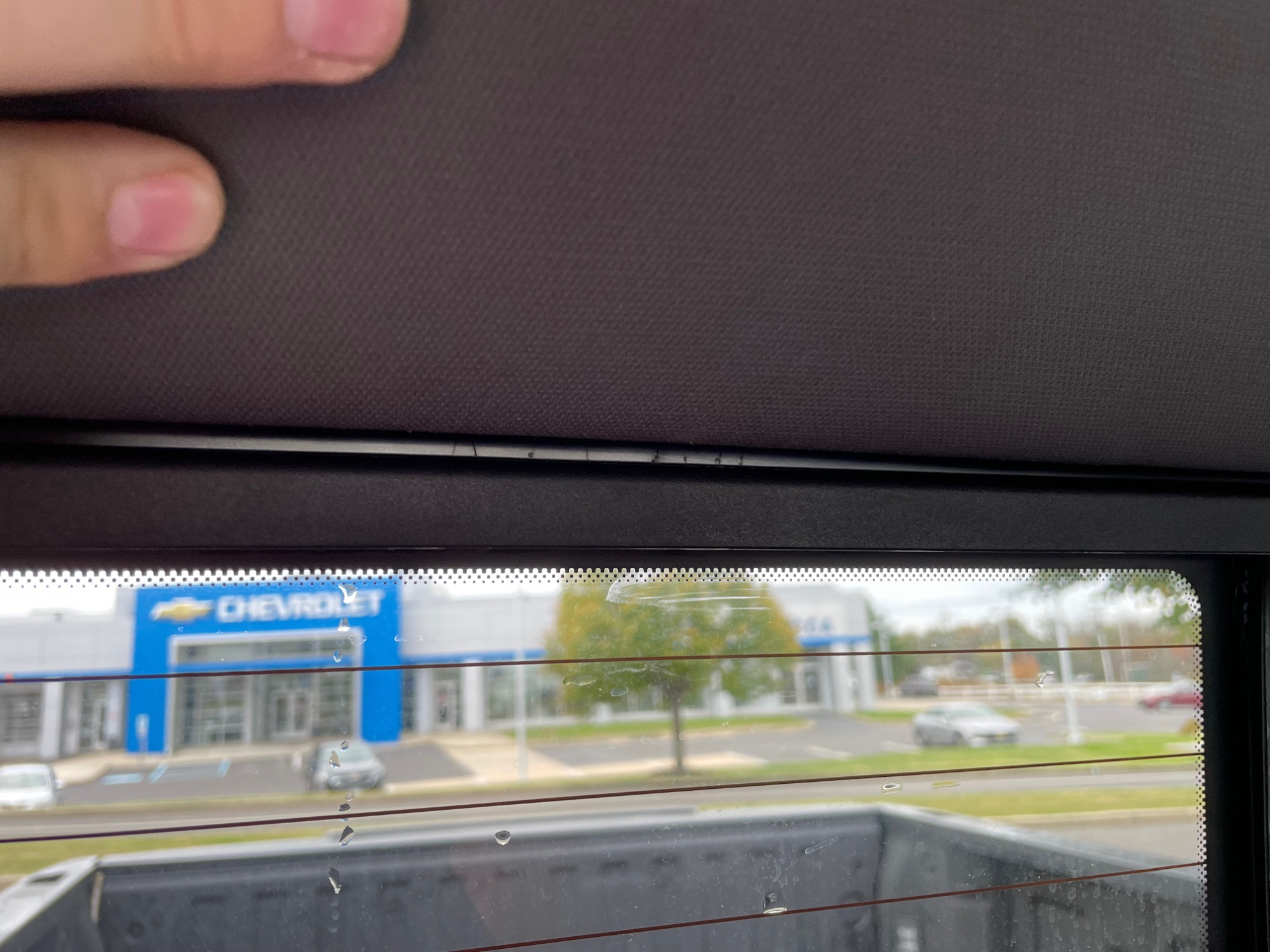

Well 1 day short of 6 months and just shy of 7k miles later I'm back!
Noticed a very small leak in the same spot after the dealer did an oil change and washed it, only a few drops but its there, walked back inside and sent them the pictures, they said they will put in the request for a new window and let me take the truck home, I text the advisor and requested a new fixed window instead of that stupid fricken slider, they said it shouldnt be a problem as far as they know and the service manager will call someone monday morning to get the window approved.
I'm not interested in the sealer or a slider, so fingers crossed they say yes, honestly I will pay a glass shop to replace the window with the non slider if needed. And to top it off its gonna rain all week, yay, towels in place. Also it is noteworthy to mention that there are 9 cracks and GM refused the replacement round 1. I love this truck so much more then my '18 F150 that Ford bought back as a lemon and dont want to go down that road over something so fricken simple to fix.

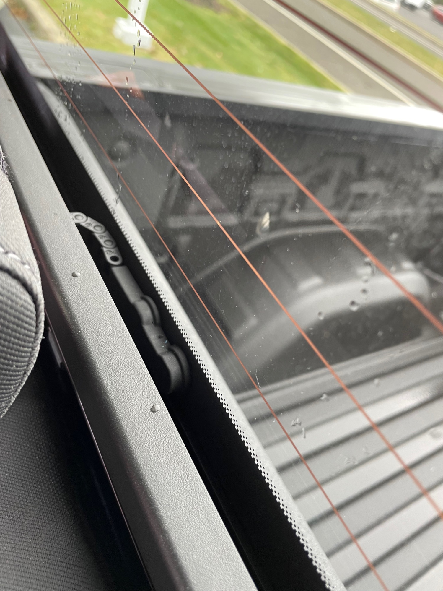

I want to smack the crap out of whatever engineer thought it was a good idea to put the plastic slider rail between the glass seal and the body, make it a separtate assembly inside the glass!
Also I looked up the parts online and the slider is not orderable, hopefully that means I get solid glass!
