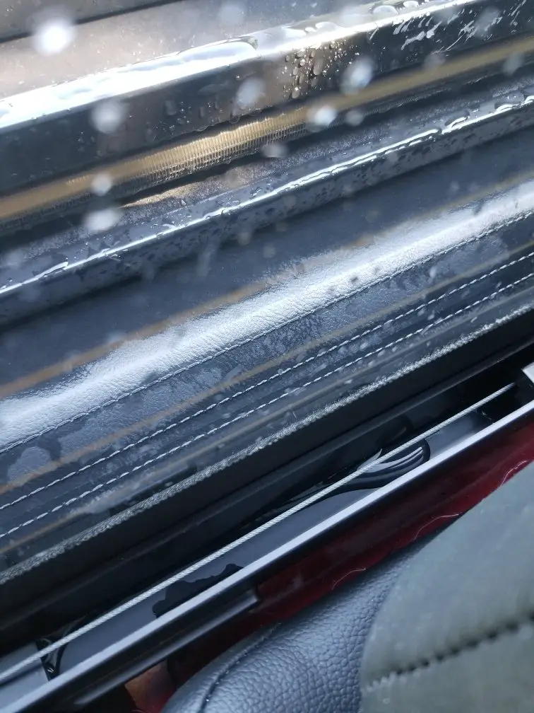

My truck has been in 3 time with this leak and the first 1 time getting it back it was like a water fall and the second and third are very little leaks and they replaced the headliner and rear window itself and it's still leaking after the third time of getting it back and it's in the same place as before and in in the lower track of the window now too. I believe at this point is is something Wrong with the design of the trucks water draining system from the roof causing the water to get into the vehicle (pictures are from the most current leak)
