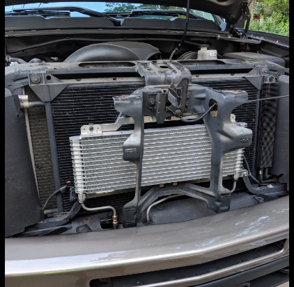

Idk where you live but I’m in SoCal and in the summer time, IT GETS HOT. Plus I’m boosted and got a heavy foot. So here is my suggestion:
*Mishimoto radiator
*Katech 174* thermostat.
*truCool 40k trans cooler (run it inline AFTER the radiator’s trans cooler)
*flip the factory gut of the trans Tstat. (Look it up on YT, takes like 5 mins with 1 hand

When you mount a large aux cooler directly in front of your factory radiator, are there any issues with reduced cooling to the factory rad?

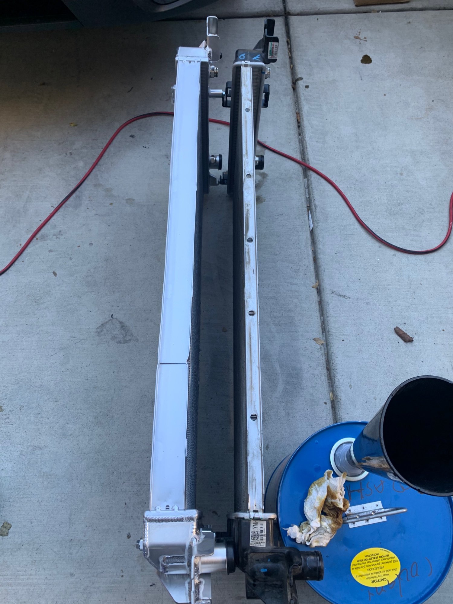

i think the Mushimoto rad is a bit over priced, not sure but the 6.2 rad is much larger than stock 5.3, and probably cost $350 vs $900 for mushimojo
Is the 6.2 a direct replacement or is different mounting hardware needed?
i havent done the conversion , as my stock unit still maintains ok temps in my climate,   i noticed durring dyno runs the 5.3 got hot hot very fast with just 2 pulls, so power adders and hot climate along with towing would make it a good upgrade, when it comes time to change out the coolant
Same radiator but there are two. NHT is a bit thicker.
Maybe a dumb question but what's NHT? The 6.2 rad?
