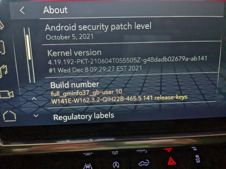

Check the build Id on your radio. My dealer dicked me around too and said the truck wouldn't accept the update.
Setting->About->Build Number
Mine looks like it's at w162, whereas the fixed version is w164 per that bulletin
That being said, maybe my truck did an ota and 162 fixed it because I have not had the problem since 8/13

But it is correct.  I just did the update to my truck.  The only reason this would NOT be the correct bulletin is if you have a different radio option.  What trim is your truck?
22-NA-142: Radio Software Version W164 – Multiple Updates - (Aug 3, 2022)

Yours isn't updated.  W162 is an older software.  My radio was the same build data as yours and had static 3 times.
Here's mine after the update:

Mine says W149E-W163.3.2-QIH22B-515.1 149 release-keys.

Here's a pic of mine after the update.  The second # is the one you gotta look at.
