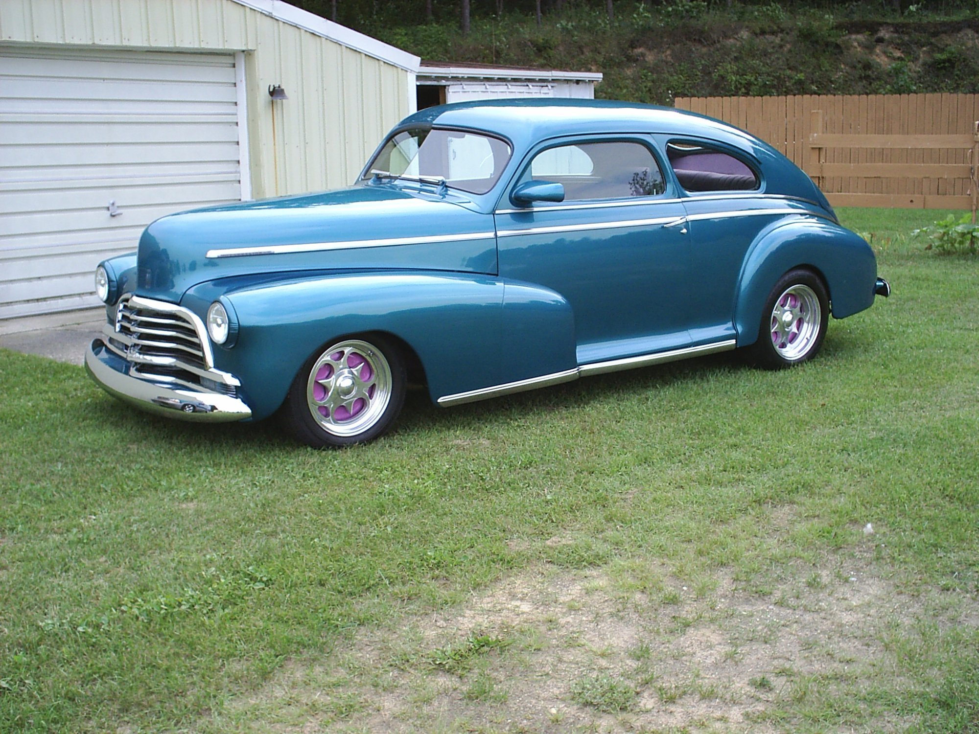

1992 Chevy truck teal is the color I picked for my dad's 1946 Chevy Aerosedan street rod.
