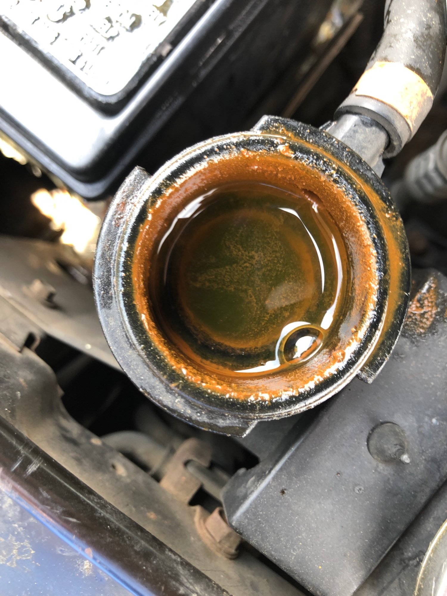

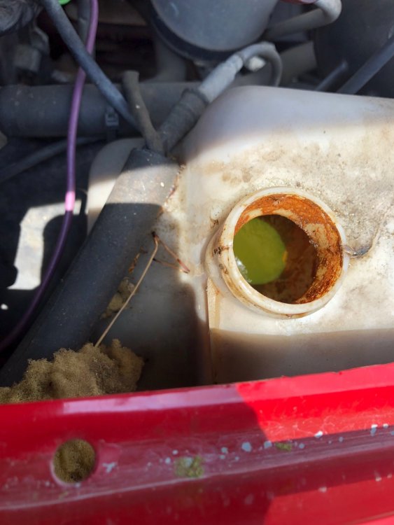

Just found this issue as well with the coolant
Looks like you have two different coolants mixed. The brownish is the dacron made for newer GM vehicles. The green I would say was Prestone. I would drain all of it, keep all drain plugs open, run your hose thru the radiator, the fill tank, just flush all that out. Take top radiator hose off radiator side, leave other end connected to engine, turn hose on, have someone turn engine over for a couple minutes. This will flush out the mix internal in engine.
  Let it sit till all fluid and water is down to a drip. Then put plugs back in, 89 shouldn't need dexron, but y pi y can use it. But you need to pick one and only use one. Those two combined after awhile will form a gell that seizes up your radiator and forms in your engine.
