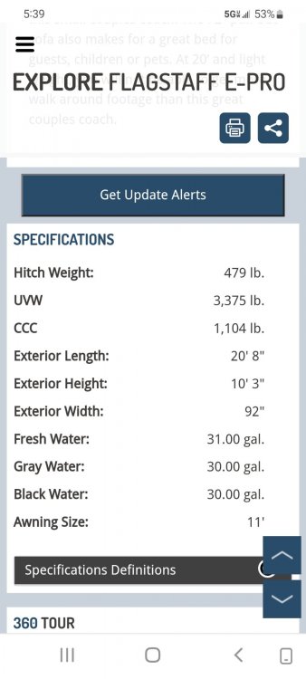

What's the weight of your trailer ready to camp?
It looks like you are too heavy on the tongue compared to the weight of the trailer.
Is all your cargo up in front?
Go to a CAT scale at a truck stop and weigh it
Edited by dieselfan1
Tongue weight measured at 629.4# with front sides storage filled.  Most stuff stored in back so when we get on site we can unload out the door.  One variable is fresh, grey, and black water.  That will change day to day, despite a theoretical equalization.
