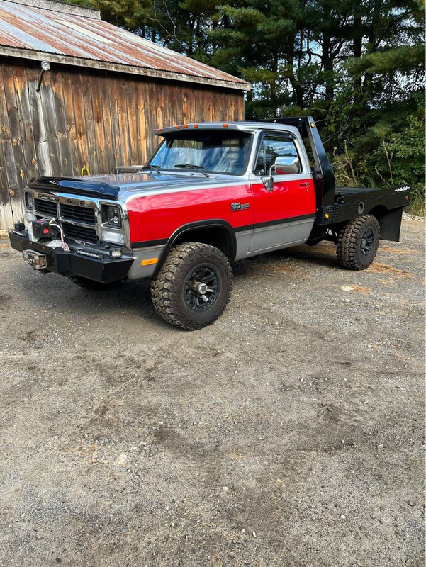

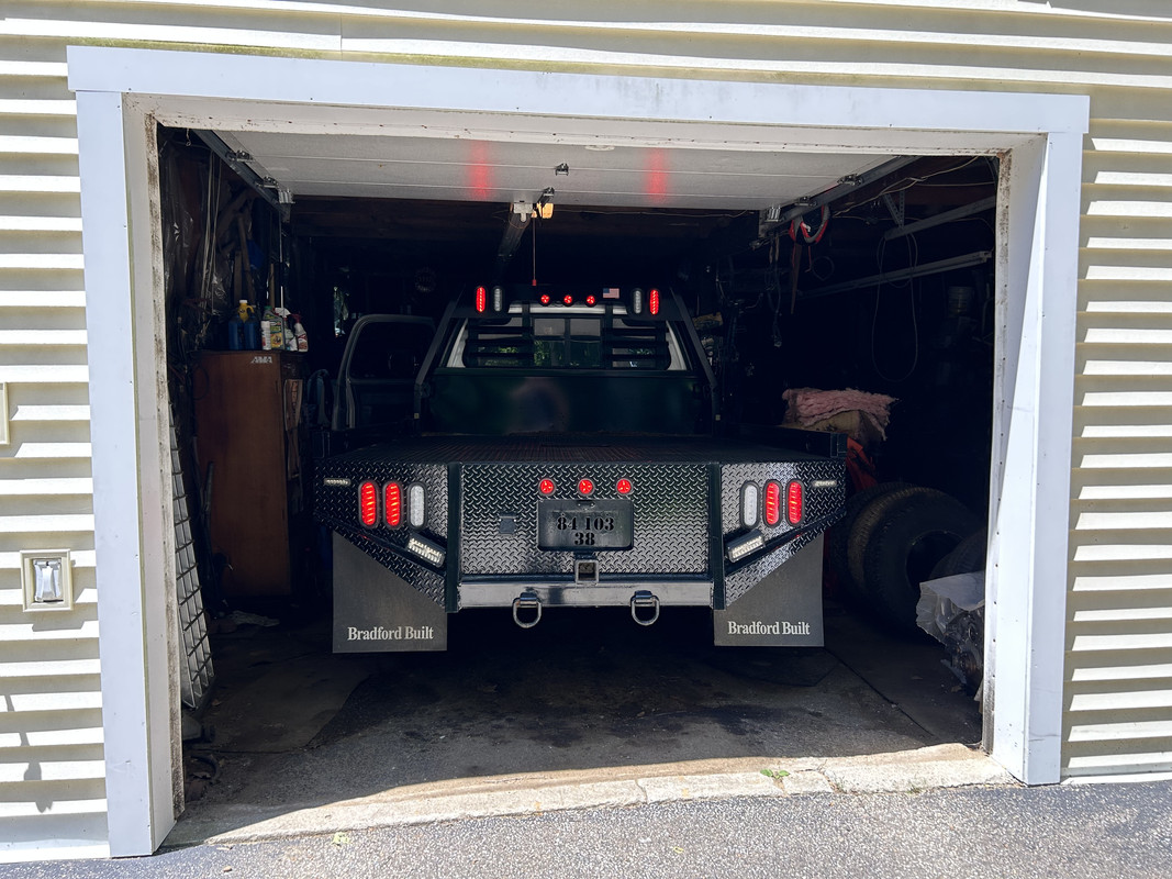

I finally threw in the towel and dumped that POS Silverado after 16 agonizing years. Replaced it with a '93 W250 with a Cummins and a 5-speed. Couldn't be happier! Thing is a breeze to modify and maintain, completely unlike the Silverado. And it tows effortlessly, without having to scream the engine to 5k on every hill.
Should've bought this thing 30 years ago!
