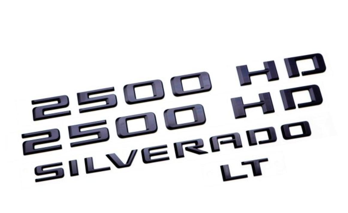

I don’t have them but just use a level and a washable marker or dry erase and mark a line and put all your decals on that line and for spacing you could use a pencil or something that is at the right width apart and just keep using that item to space them all out. Would be easy.
i am 99.99% sure they come preadhered to a sheet of sticky paper. you pull the sticky side of the lettering off, then align the sheet with all the letters adhered to it. press, then pull the other sheet off
I was thinking of swapping from my silver letters. I'd probably put some blue tape under the originals, remove them, then add the new. If your worried about losing the tape line during removal, add a second tape line directly under, remove the forest then remove the letters. Then add back a new tape line above the one you left to get back to oem height alignment.
