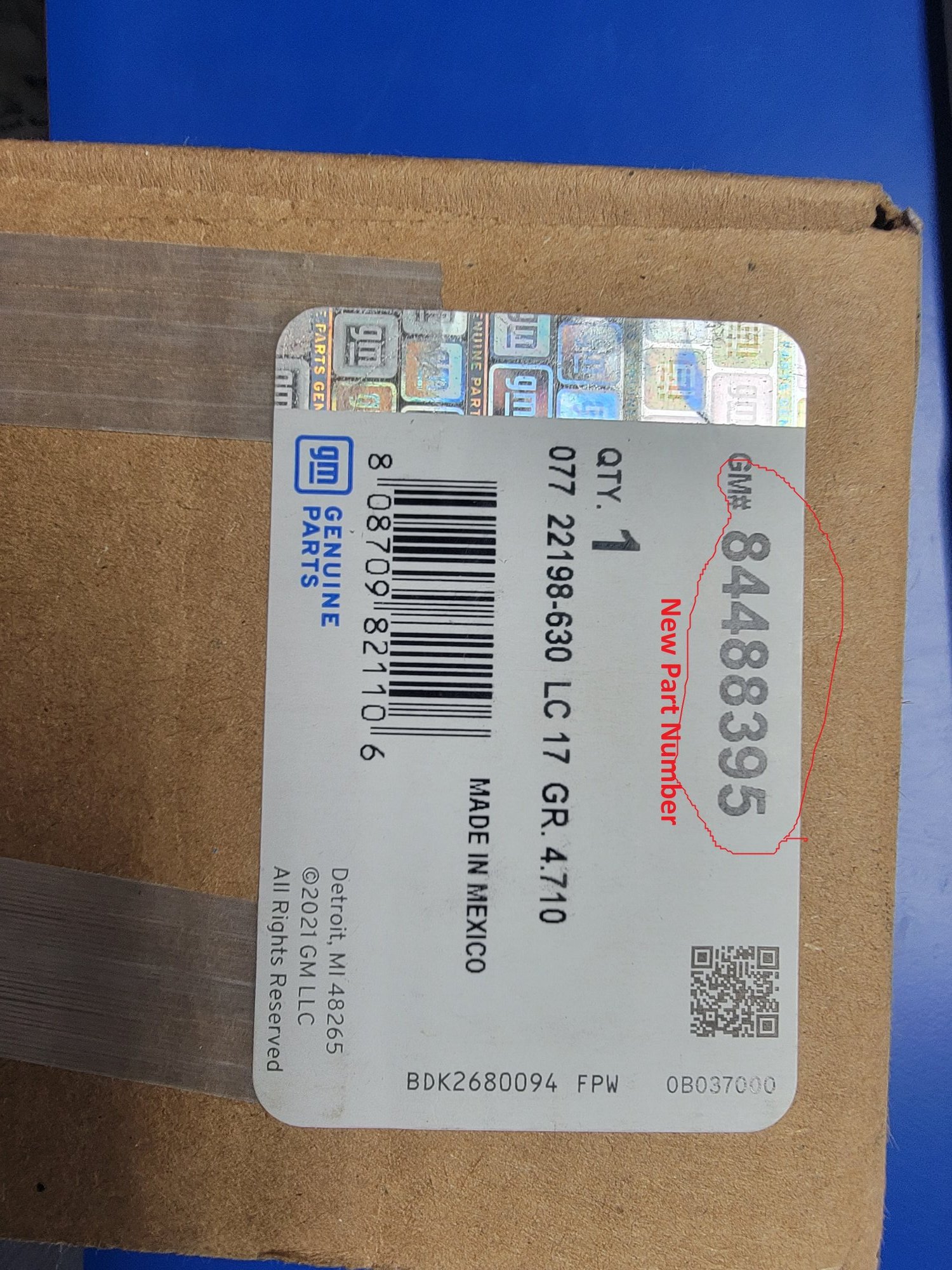

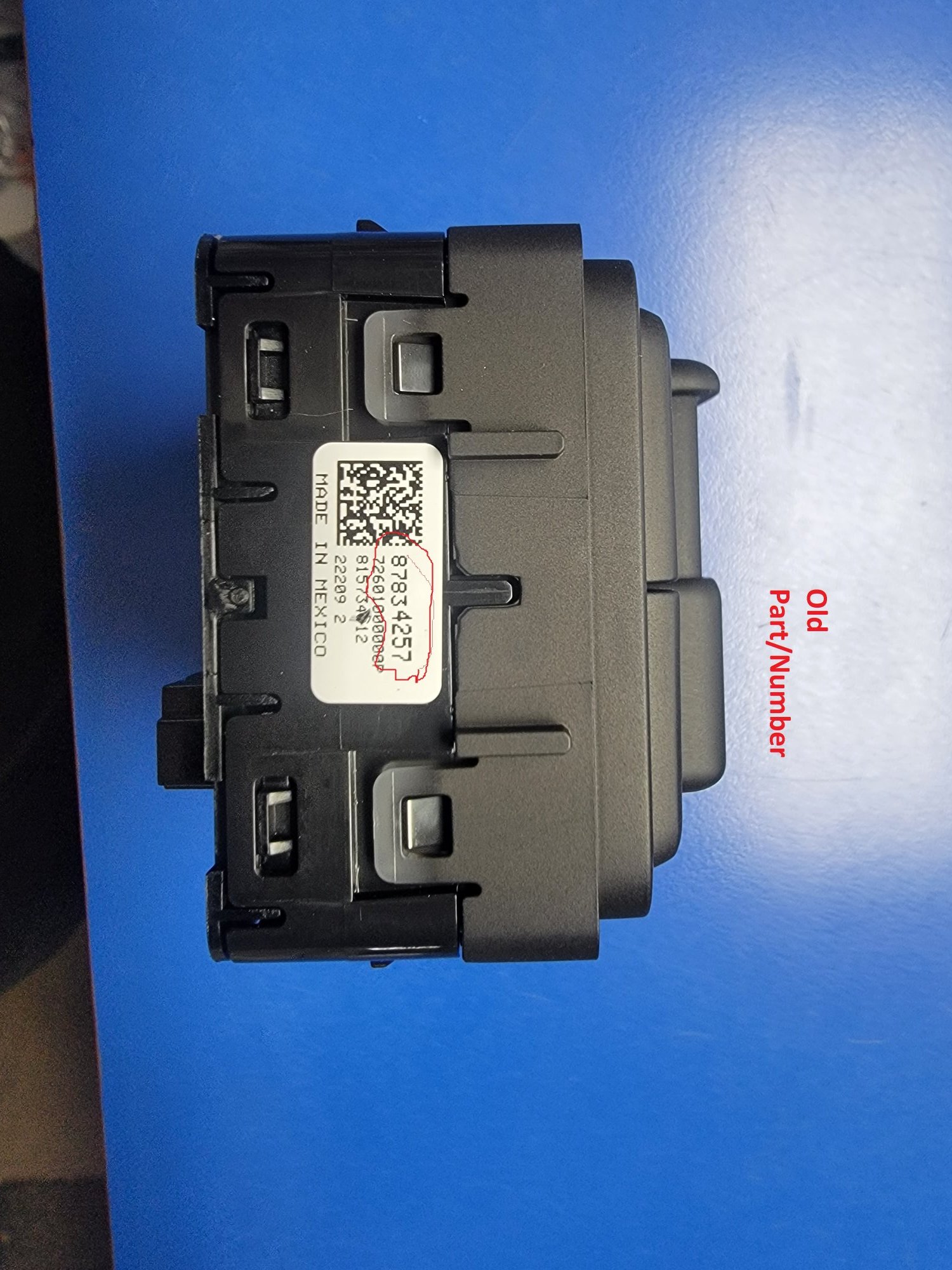

Everything In Daniel Murphy's post looks exactly the same as the TrailBoss I have.  The only thing that was slightly tricky was once you have all the screws out of the heater controls trim, pulled carefully on the right side of the heater control trim to release the clips securing it to the carrier/dash behind it.  Still had resistance on left upper heater control trim.  I had to carefully pull out very slightly on the information trim just enough to remove the heater control assembly, by sliding it downward from under the radio/upper dash trim.  Then I was able to swap out the trailer brake control switch.   Just an FYI  I called by dealer parts dept with the part number from the switch I removed, and was told that that part was superseded/updated to the new part number.  I have a hunch the old part number was pre-refresh stock/parts and the refresh software is not compatible.

With your tutorial I was able to replace this switch in about 20 minutes.  Local dealer had one in stock (New P/N 84488395) for 20$.  Towed about 100 miles yesterday and today without issue.  No more alert message/trailer brakes disabled and Braking is much stronger on the trailer now.  I had to back the gain down to 6 to prevent tires from dragging.
