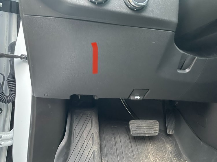

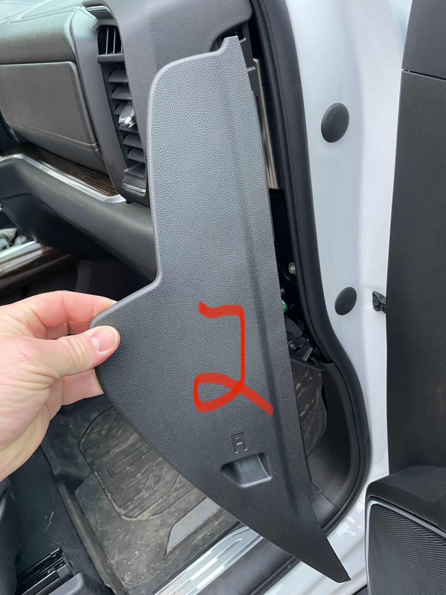

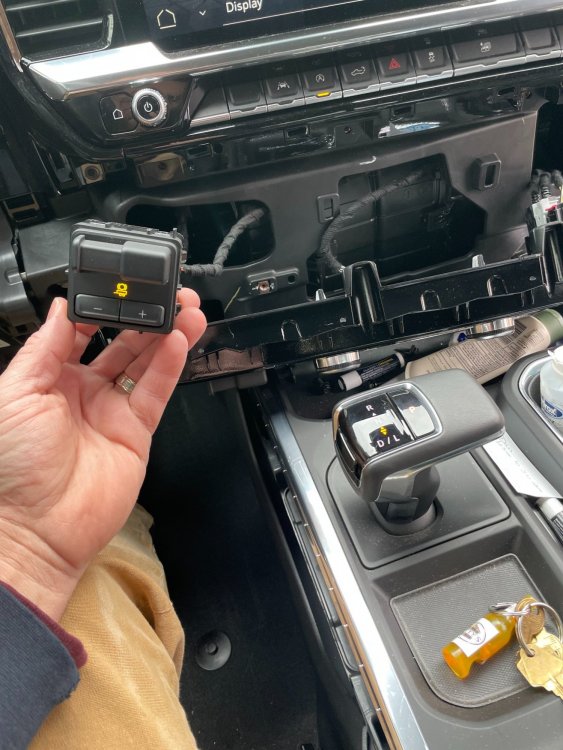

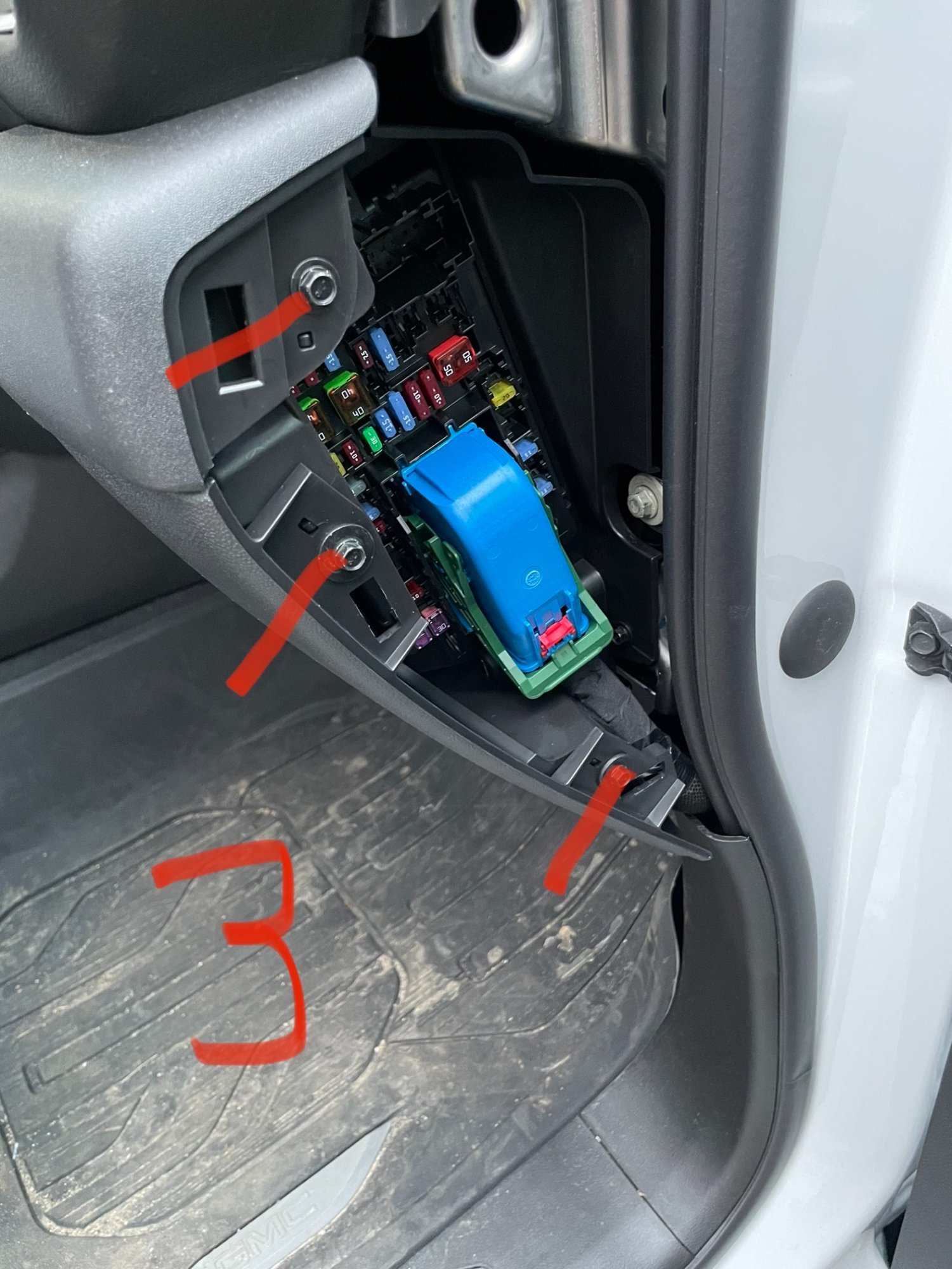

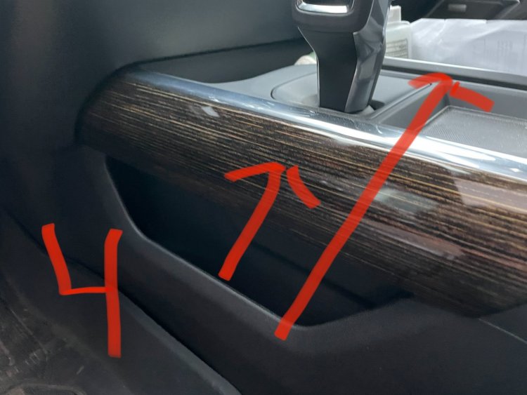

Hello,
I connected the new switch and it worked without any programming.  I was wondering if it was going to work as i was figuring out how to take the truck apart.  So when i got to the point where is was able to unplug the old one, i plugged in the new one and tried it first before reassembly.  And it worked!
Here's what i did on my 2022 GMC Sierra 1500 Elevation - (This may not apply to older models (Chevy, older models, ??)
1 - Pull of panel located near hood release.  Remove hex head screw (7mm socket) that holds the next panel to the right of the first panel you just removed
2 - Remove passenger side fuse panel cover and (3) hex head screws

4 - Remove both trim peices on the side of center console - grab from underside and pull out, then slide back a little

7 - Remove hex head screws holding bezel in place, pull out bezel from dash.
8 - Replace the switch, it pops out from the back of the bezel.  There are 4 plastics tabs holding it to the bezel.  Gently pry out on the tabs on one side and get the switch started on that side, then the otherside and remove.
Reverse order for reassembly.  Be gentle and take your time.

1 hour ago, daniel murphy said:
Hello,
