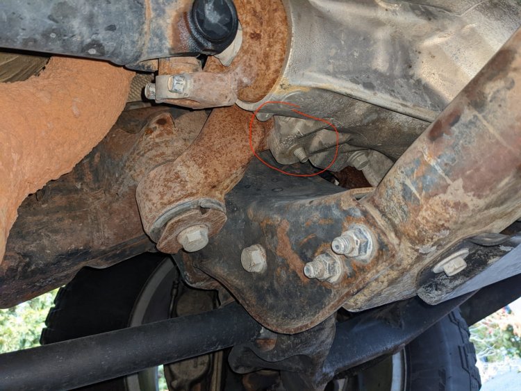

I was underneath my truck draining my oil and noticed a missing bolt right off the transfer case. Anybody have a part number for it? 1056870565_chevymissingbolt.thumb.jpeg.2cbbb874d8ec32476df60ace945aea7a.jpeg

Its not missing, when I had my 2015 HD I saw that to and brought it up to the service manager friend of mine at the dealership and told me none of them had the bolt on the lot as I checked they use it as an alignment hole during assembly.
First of all, thats the front differential and not the transfer case. Second, thats a bolt coming in from the top and thats the tip of it sticking out there. That is how the 2500 and 3500 front diffs are mounted.
