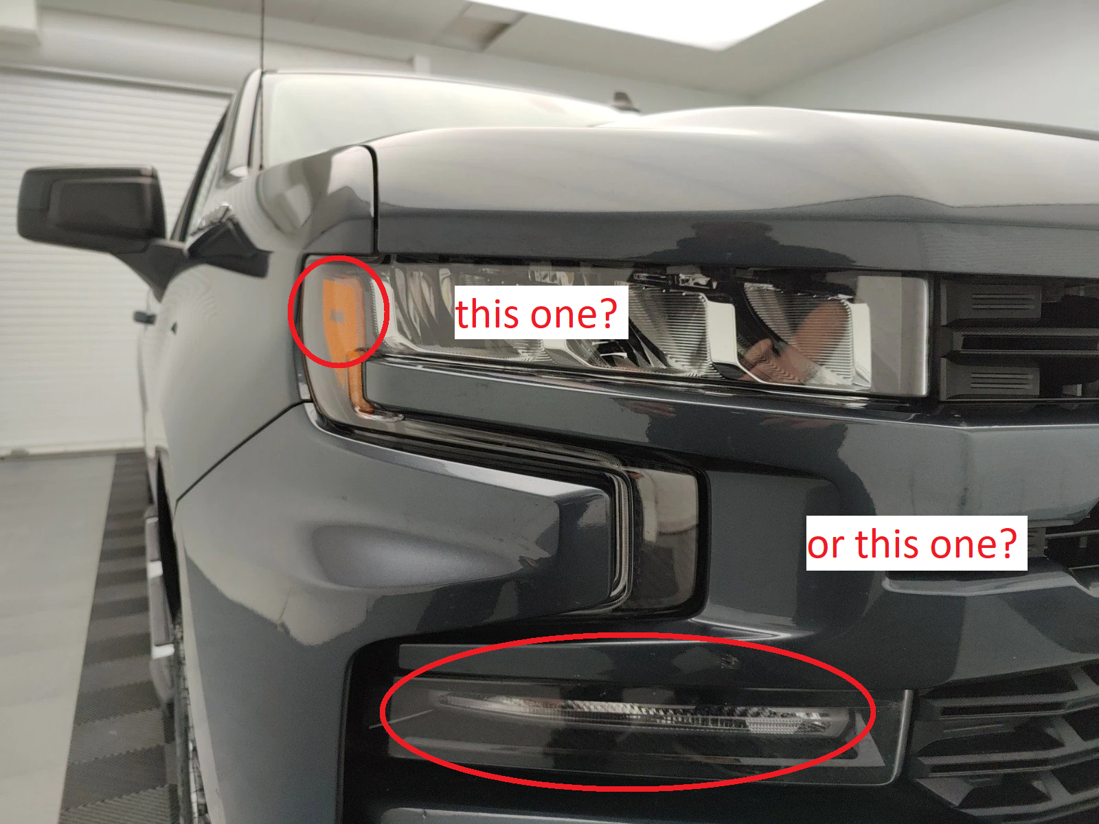

I feel stupid but I can’t find the socket to replace the front park light bulb….?
2019 Silverado LTZ.
I assume it has the same flat blade tab to twist CCW but the only thing I see is an oval shaped piece where it should be and it doesn’t want to turn….
color me dumb…

Which bulb?
I thought LTZs had the HID LED headlights with LED turn signals.
6 hours ago, DHBWA said:
The upper. Supposedly a 7443
No replaceable bulb there.  Its an LED.  The lower is the 7443 bulb unless it has the full LED lamps in which the lower is LED.  High Country for sure has the full LED lamps.  LT/RST/LTZ have the 7443 signal bulb at the bottom and then if its a Midnight/RST they get the full LED from the High Country.
Edited by newdude
That makes sense and never saw that in all the research I did prior…..and since the turn was halogen I figured the marker would also.
Thanks!
Guess I have a couple spare Lasfit 7443’s……
