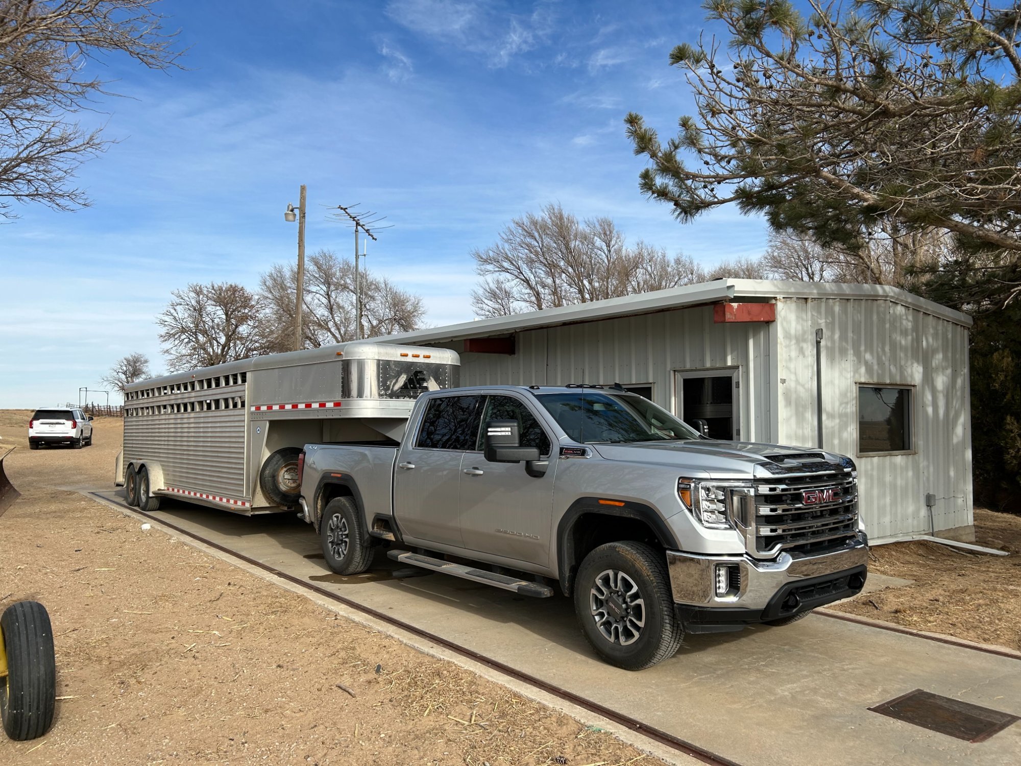

Took the new 6.6 gas on a heavy tow today.  Had to haul some 6 weight calves to the sale barn.  GCVW was just shy of 26K without me in it.  We were maxed out!  To give some perspective I live in Western Kansas and its pretty much flat.  Outside of a few climbs in where some dry rivers are, it's pretty easy towing (this isn't the Rocky Mountains out here).  I will say one thing I was impressed with how this thing did.  I still have my 15 LML and love that pickup but this new 6.6 gas ain't no slouch either.  I was mainly keeping it locked into 5th gear running between 65-70 and it did fine.  Only downshifted to fourth a couple times on some small grades.  One stretch I let it shift into 6th and it pulled it fine, but I kept in 5th most of the way just to keep tranny happy.  The attached picture of the gauges on that 6th gear run.  Never saw the trans temp go above 160 and had zero issues keeping speed.  I think the 6 speed is adequate but it's a little doggy in the mid-range.  The only flat spot in the power band is shifting into third and into fourth.  Just kind of a dead area of power/torque.  No issues on low end to get moving and once up to speed things are good.  I think the new 10 speed will correct this.  I do miss the exhaust brake though.  That's probably the biggest issue.  As far as mileage goes I was shocked.  I pulled the calves 80 miles and computer said just a touch over 10 mpg!!  Maybe I was just lucky today but that was impressive.  My LML usually only does about 11 with this type of load.  I have 5000 miles on now and seems like the engine is settled in as the mileage keeps getting better.  Lifetime mileage so far is 13 and my LML is 14.5.  Still love the diesel and plan to keep it around but I was smiling pretty big today with the performance of this 6.6.  Hope this real world experience might help someone wondering about the towing ability.  If GM got the hp up to 450 and the 10 speed there would be a lot more gassers being ordered I would imagine.

Had 21 calves on the trailer weighed 640 lbs avg.  I'd say 1000 lb steers would bring $1.70+ in this market.  Pretty hot right now.  If it ever gets to raining again out here be out of sight in 2024.  Massive herd liquidation out west past year.  We won't be able to hang on this summer if it doesn't rain/snow soon.  Driest I've seen it in a long while.
