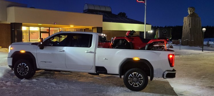

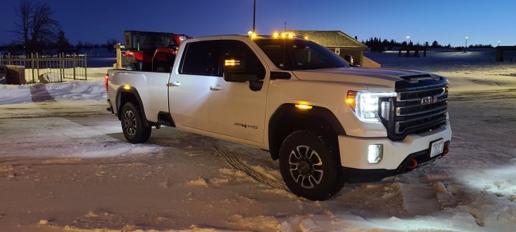

I have a 2023 Sierra 3500 AT4 long box with the snow plow prep package on 18" wheels and I'm happy with the ride quality. I've spent most of my driving hours behind the wheels of sports cars and my 3500 is a Cadillac by comparison. I just drove 1,800 miles in the last week with only an ATV in the bed.
