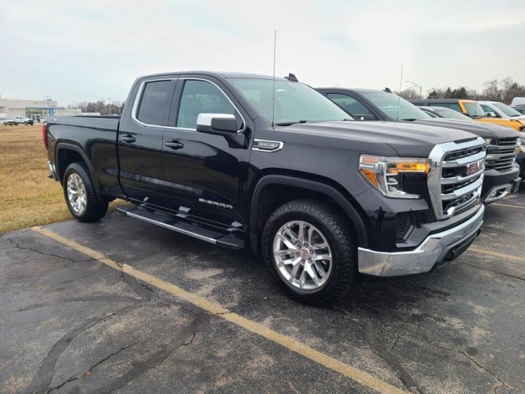

Hi all. I just joined this forum to help me with upgrades to my newly acquired 2019 GMC Sierra 1500 SLE. It features the X31 off road package along with 20-inch wheels and factory 2-inch lift. I installed the factory performance exhaust and have a cold air intake on order. I just ordered a factory fog light kit and am looking for the installation instructions. I know I will have to have the dealer program it but no issues there. I looked on the web but so far, I have not found them. Can anyone help? Thanks for any help you might provide.
1548414911_-8874410049627118808(002).thumb.jpg.e72f23edec26214fe7401adb650441eb.jpg Here is a picture of it at the dealer when I picked it up.
Welcome to the Forum, nice looking truck. The factory system is cold air intake so all you gain by changing it is looks

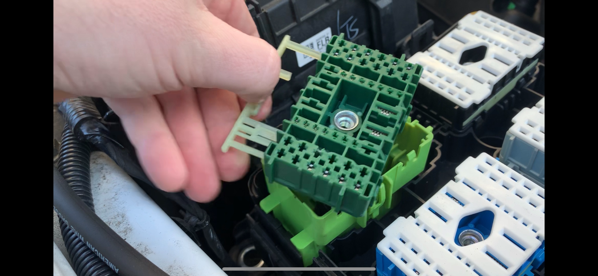

Its not depicted in the instructions, there are 2 plastics locks on the sides of the green(green for me) fuse block that you need to remove a connector and add a connector, you HAVE to remove the locks prior to pressing the release pins/captured connector. 1938322030_Viewrecentphotos.thumb.png.67fd24a952bb23463ce1b9aa2c8b1e05.png
