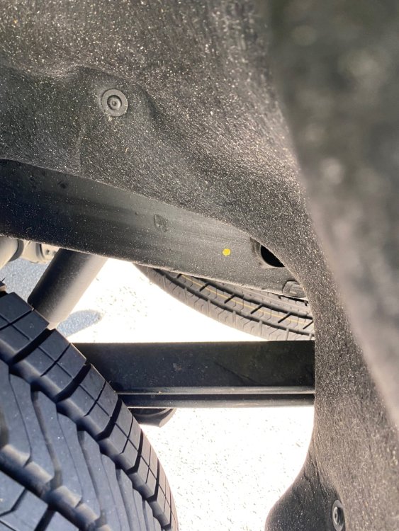

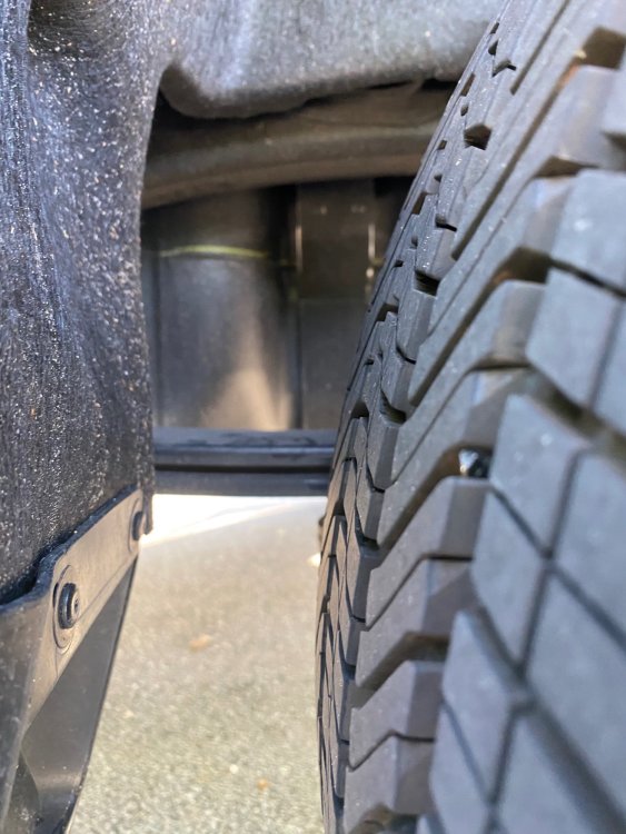

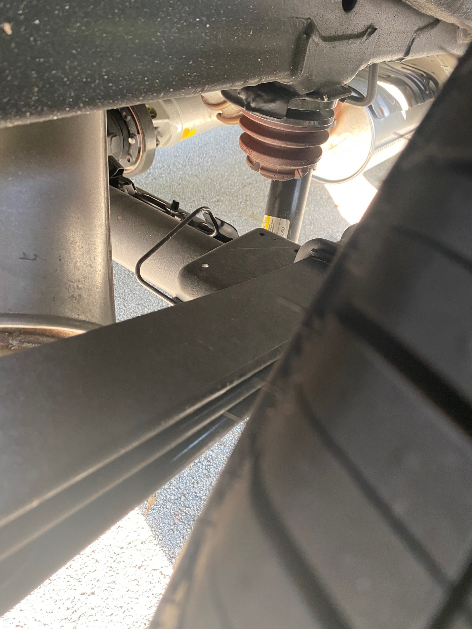

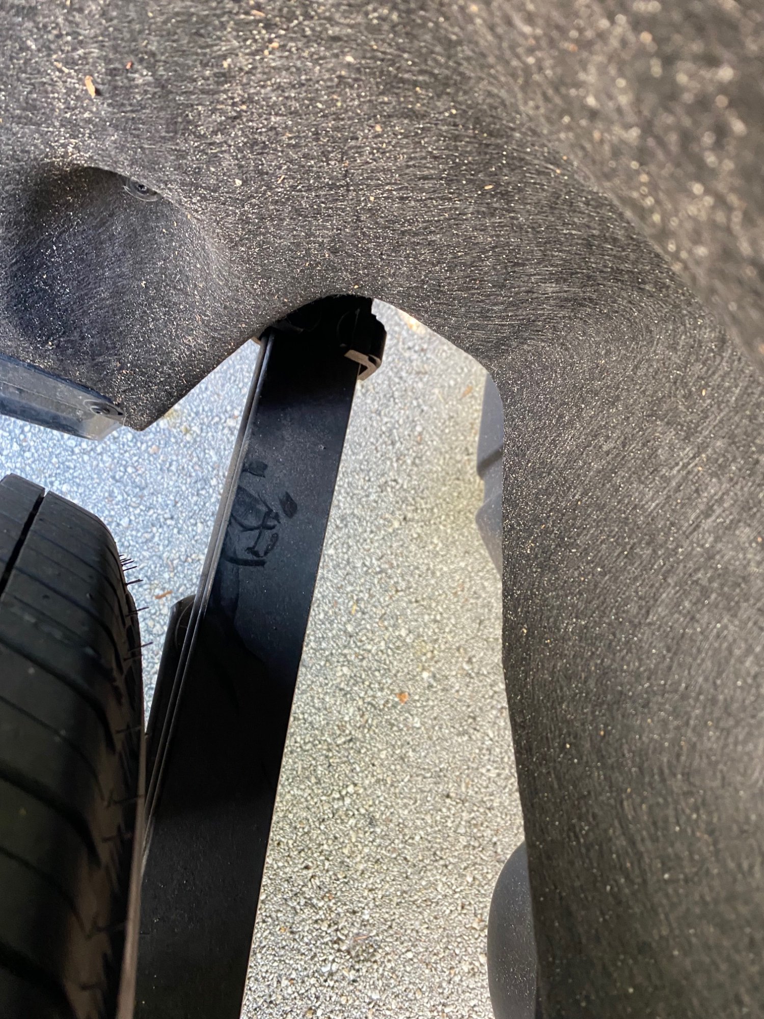

Can anyone tell me based off of these pictures if I have the rear mono leaf suspension? I don’t think so but want to confirm.
No you do not have a mono leaf rear suspension. Mono leaf is a single leaf spring. I can clearly see at least 3 springs in your photos.
Definitely the traditional steel spring pack.
The mono leaf is literally a mono leaf.  One single composite spring.  It looks a good bit different too.

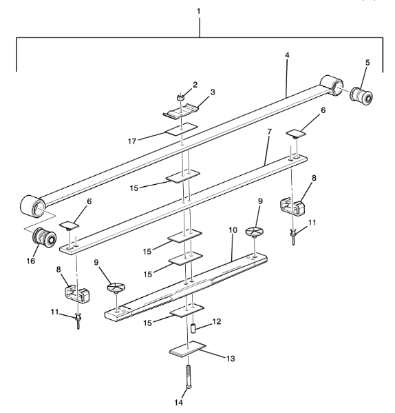

That said, some of these trucks do use a composite lower spring on the steel pack.  5.3 and some 3.0 Duramax in LT trim on Chevy.  All you need is a magnet to test these out, top two springs it would stick, bottom one it wouldn't.
Mono Spring
Bottom Composite With Steel Uppers (note the bottom spring)
Full Steel Pack
