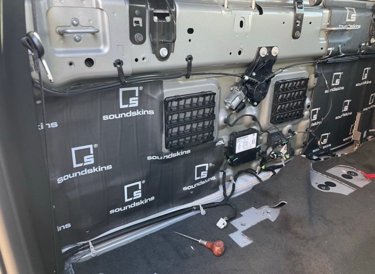

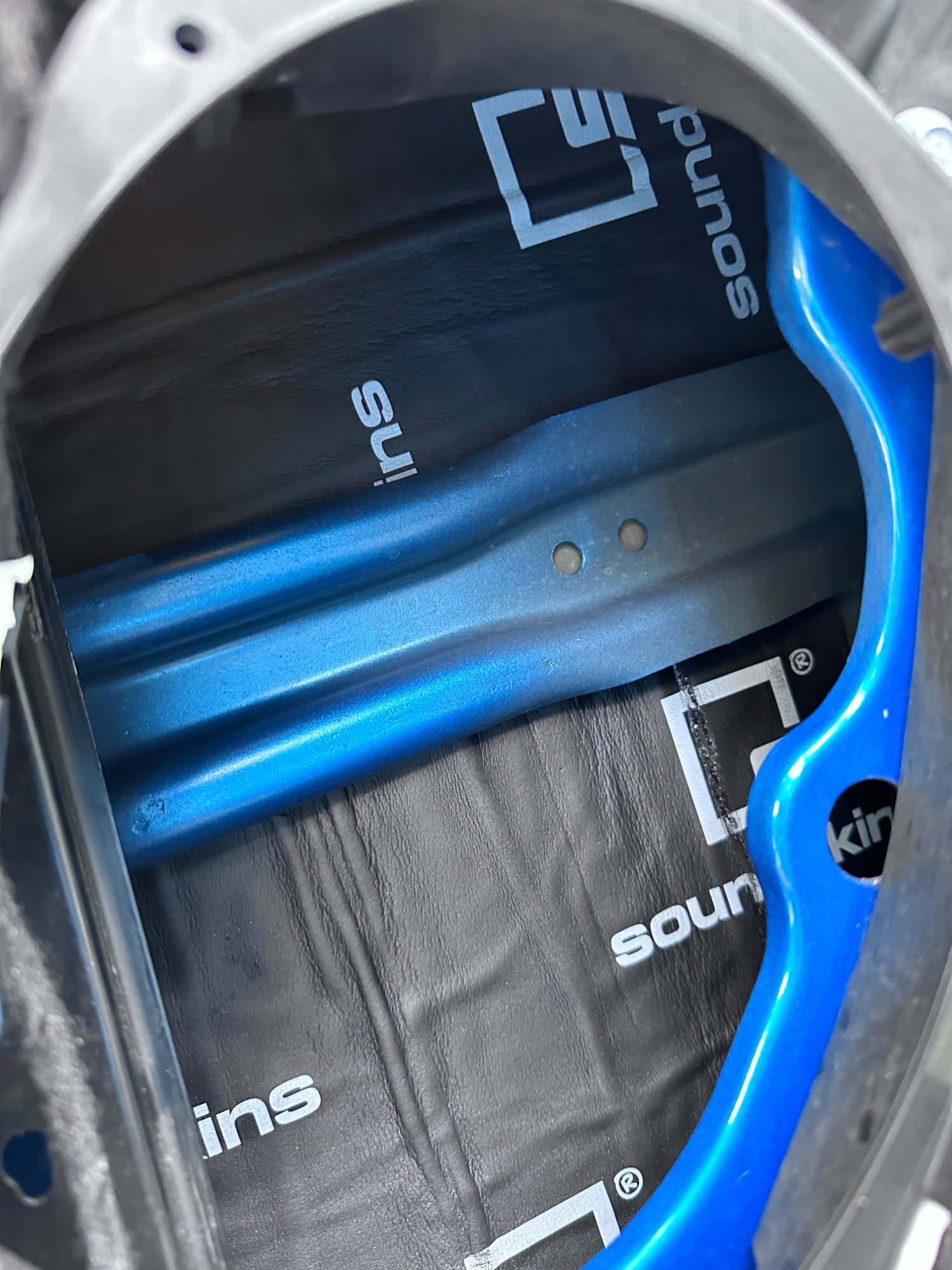

I usually do at least a little sound treatment on all my vehicles. For the Ram it was the back side of the doors and and the cab back wall. Wanted to cut the drone a little and make the doors close with a more solid “thud”. SoundSkins Pro is a great product. Followed up with 3M Acoustic Thinsulate. IMG_7371.thumb.jpeg.dcd029d9691b91e07b56db5c4ff6699a.jpeg
On this Jeep I’ll probably do the doors and that’s it. It’s very quiet as it is but could be a little better.

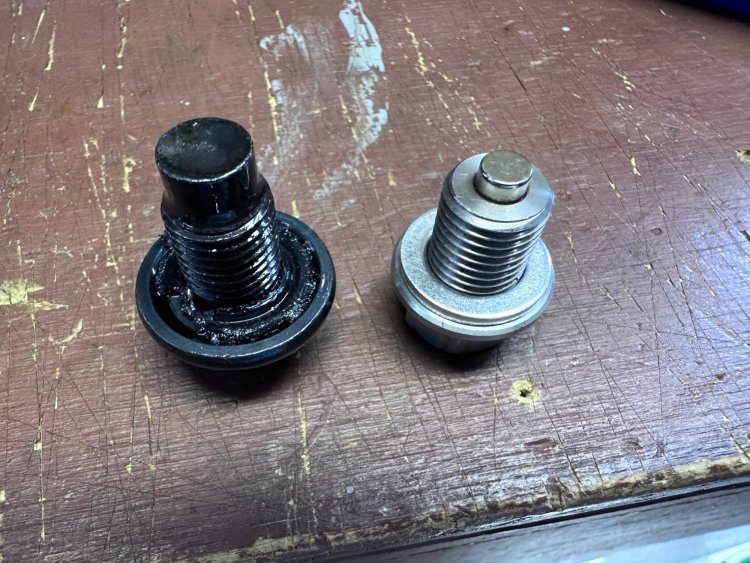

Finally was able to get the oil change done.
Of course with any used vehicle the guy who did it last leaves you a surprise. In this case it was a drain plug with a degraded rubber washer. Their solution? Torque it to one million foot-pounds. Thank god it’s a steel pan or that could have ended very badly. Still puckered me up a bit.
Replaced drain plug with a Votex magnetic I took off the TRX to install the Valvomax, and a new crush washer. All is well. Also did Red Line SI-1 in the tank, and tried out cosmoline on the sub frame, oil pan and other metal parts underneath for corrosion protection.

AMSOIL's Heavy-Duty Metal Protector works well as an undercoating.  Dries to a wax film.  Several customers use it for that purpose and love it.
