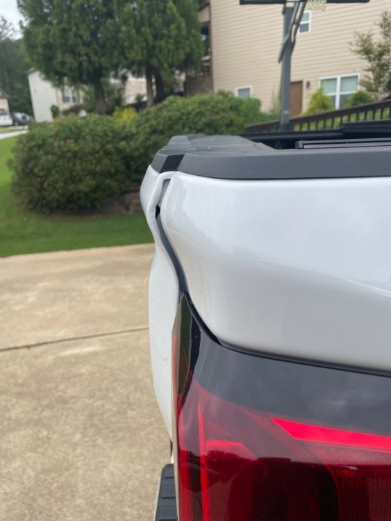

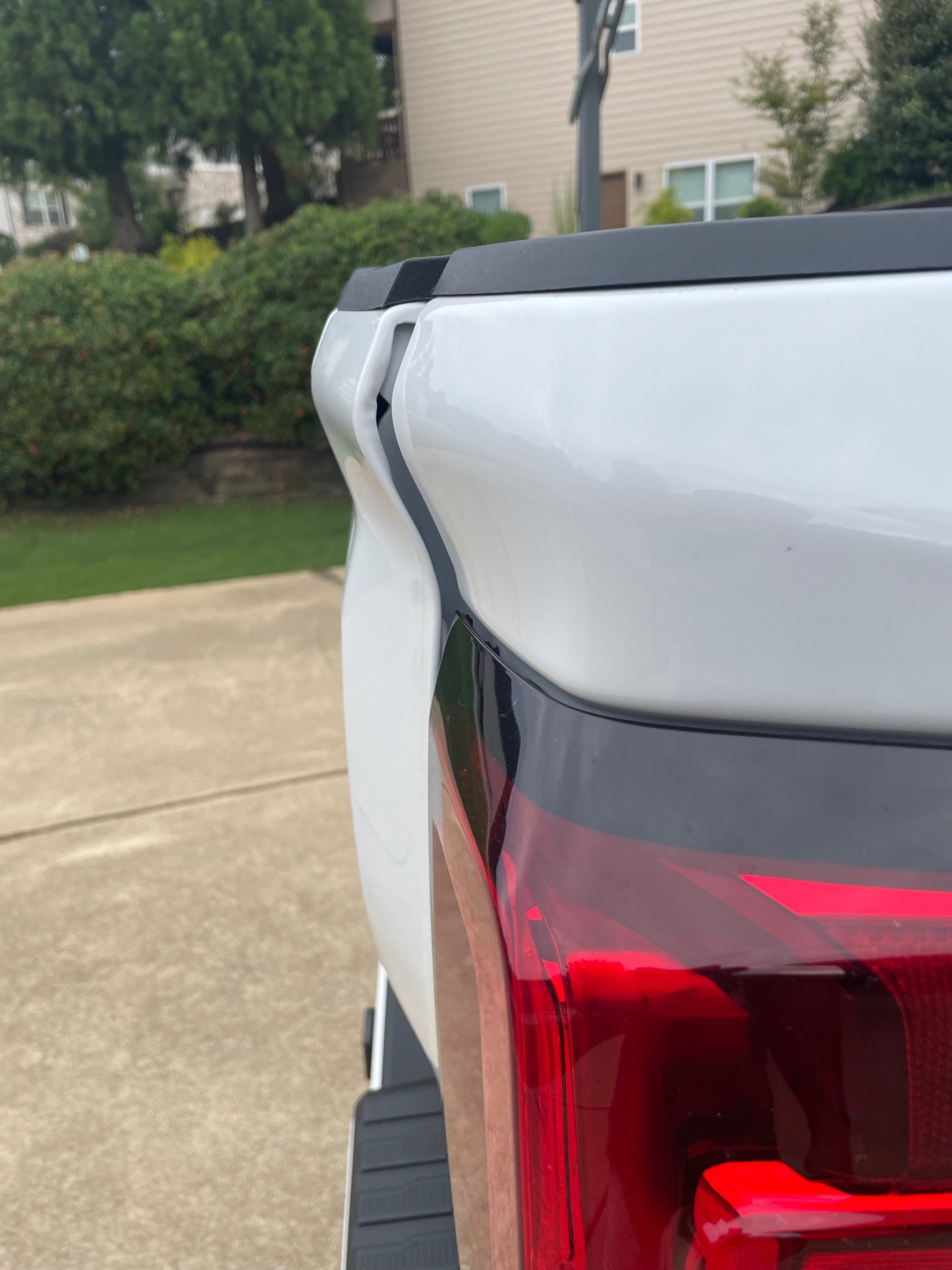

Just purchased a 24 1500 AT4 and I love it, with the exception of the rear tailgate that will not shut flush. I had it at the dealer for two hours yesterday and they maxed out the adjustments, but the tailgate on one side sticks out a little more than 1/4” on the side. The tech thinks the tailgate is warped so they are sending me to the body shop next week to determine if I need a new tailgate.
Has anyone had their tailgate replaced? I’m a little nervous that a) the color isn’t going to perfectly match and b) the install won’t go well with all of the wiring. If I bought this used I think I could live with it, but not for $74k.  Dealer has been great to work with but they’ve never seen it.  Any ideas what the cause is? What would you do?

It’s pretty easy to check if the tailgate’s twisted. Open it and look carefully at the surface from the side maybe six feet away.  If it’s twisted 1/4 inch it will be obvious.

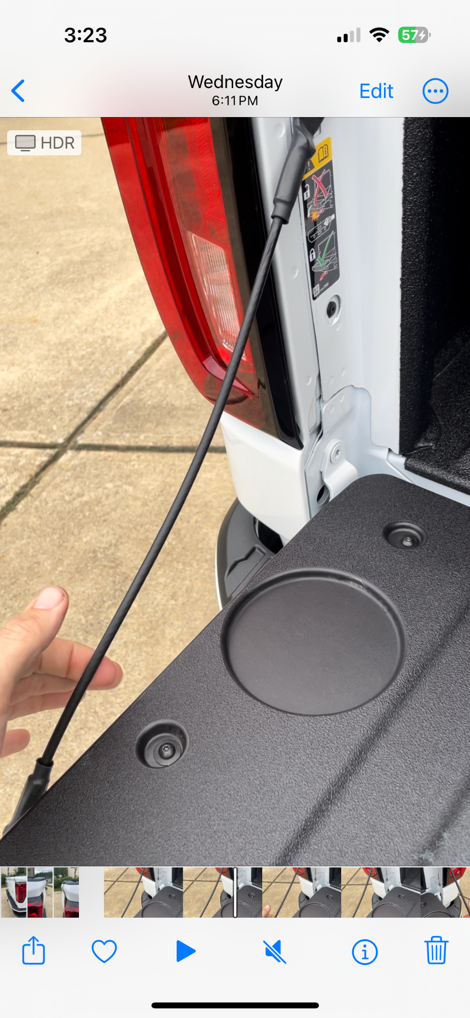

Thanks for the reply, that makes me feel better. I’ll get some pictures of the hinges tomorrow.  I will say one other thing I’ve noticed is that the tailgate cable is taut on the right side (the side that isn’t flush) while the cable on the left side is loose—or rather has a good bit of play in it.  Stated a better way, when the tailgate is down it seems the right side cable is the one supporting it (it’s tight) and the one on the left has a lot of play in it. Not sure how this factors into the problem, but I suspect it does.

Check the hinge and bushing on the right side. You can see the slot. There is a corresponding flat spot on the tailgate side hinge when it's about 50 degrees or so. Pull it out of the hinge and check for damage to the hinge on the truck and tailgate side, then put it back in place. Mine didn't want to come out of the left side when I installed the tailgate light bar and I just needed room to stick it in place so I didn't mess with pulling it off. I had a saw horse that I put a towel over and with the right side hinge disconnected, I pulled it back some and set the tailgate on the saw horse while still being in the hinge on the left side.

The hinge I think is bolted on the bed and tailgate both with counter sunk torx bolts. There really isn't any adjustment there, but if the hinges are bent, then they won't allow the top to latch.

You hinge is bent. Someone probably backed into something with tailgate down. Probably thought it barely touched and didn’t tell anyone. That’s exactly how mine looked on my last truck when someone hit that side of my tailgate while it was down. It’s not just the hinge on the outside, there’s a PITA to get to spring on the inside of that fender as well. If it’s not 100% perfect, you will wear out the slow close bushing super quick over and over. Probably also need a new tailgate.
I was never able to get it perfect on my previous truck.
