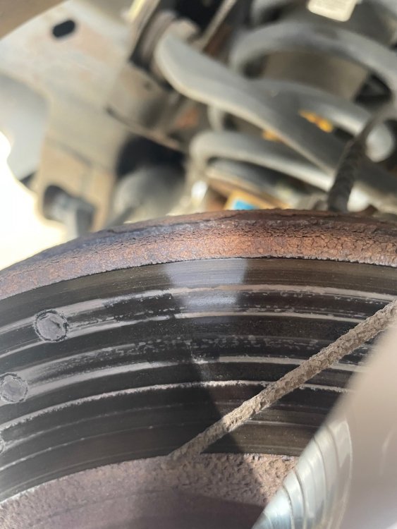

I’ve been running Powerstop z36 rotors and pads and am getting very short lifespan with the front pads. The first set went 39k miles and the second set (no rotor change) lasted 30k. Are others seeing similar pad life? Also, I did not expect a wear issue so soon until hearing a very faint squeak today only to discover both rotors severely scored. There was no noise this weekend and after a short drive today, the rotors were toast. I would have expected at least some noise from a wear tab but no warning until a faint noise developed. I’ll inspect them this week when new parts arrive but curious if others have experienced similar performance and lack of low pad thickness warning.

Those slots and drilled holes are plugged right up.  Wouldn't be surprised if those have just been eating into the pads, and it appears so based on the circumferential marks/groves that line up with the holes.
I'd be getting some nice coated rotors that aren't drilled or slotted, and a nice quality set of pads.

I appreciate the passion for the GM OE brake parts. I run a mix of OE and non-OE on other cars depending on the intended performance. I get 30-50k miles on German pads in a sedan but the compound is much softer and has incredible bite. I switched to drilled and slotted rotors because I warped two sets of front rotors on mountain drives after they overheated. The heat dissipation on traditional discs was not adequate.
I have no doubt that everyone is getting 100k+ miles on OE pads and I'm sure they are great for daily driving. That doesn't necessarily mean they are great for towing or HD use. There are always trade offs. I've had meaningfully improved braking performance with the z36 setup and in my opinion, it has been worth the change with the sacrifice of pad life. I just didn't expect pad life equivalent to German non-ceramic pads.
I was looking for input from others who are running the z36 pads to compare longevity and confirm if there's an issue with the wear tabs which should have given me a heads up on the pad thickness. Debating brake part choices is like debating oil brands and what type of woman you prefer - everyone is right.
