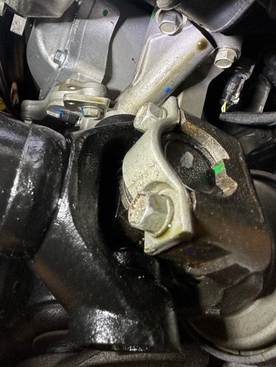

Anyone think this is the infamous oil cooler leak. I’ll be taking it in but curious what anyone here might think. I did my first oil change about a week ago and noticed oil accumulated on bottom of trans. Wasn’t quite this bad. I cleaned at all up and had it spotless so i could keep an eye on it.
just got back from 800 mile trip and this was the result.
it’s not bad enough to drop. Garage floor is spotless. But it’s dripping under pressure and has gotten on the oil pan and underside of front edge of trans. Most is there next to oil filter.

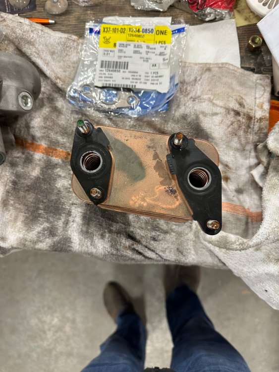

It was the oil cooler leaking. Parts on backorder with no ETA.
Already been in shop for 16 days and no end in sight.
Maybe I'll get lucky. Going to stay hopeful.

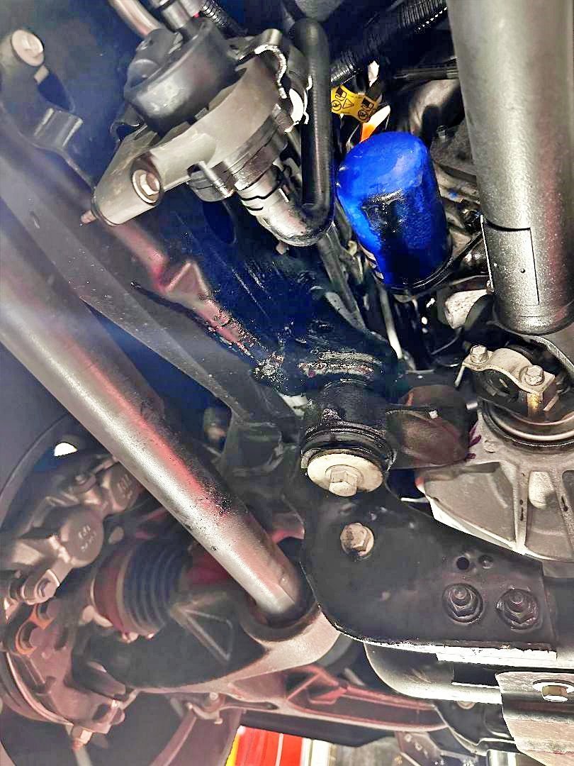

I assume that's my issue as well. I went to do my first oil change yesterday and the tech asked, "who did the last one"? I replied nobody, it's never been done and he replied BS or you have a bad leak and you need to go to the dealer asap. Well, I looked and there is oil everywhere. I have to assume it's the oil cooler as well from the looks of it? My oil level was not too bad he said.
Looks like it.
