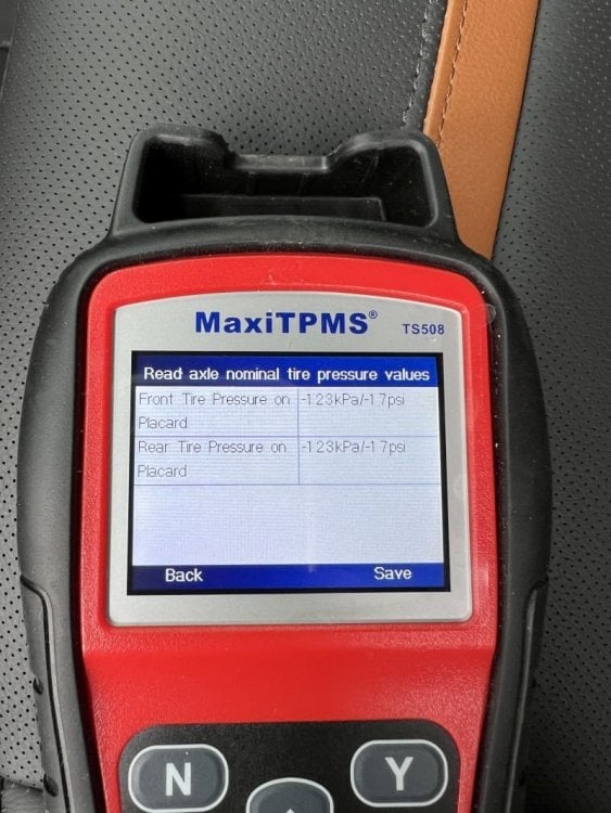

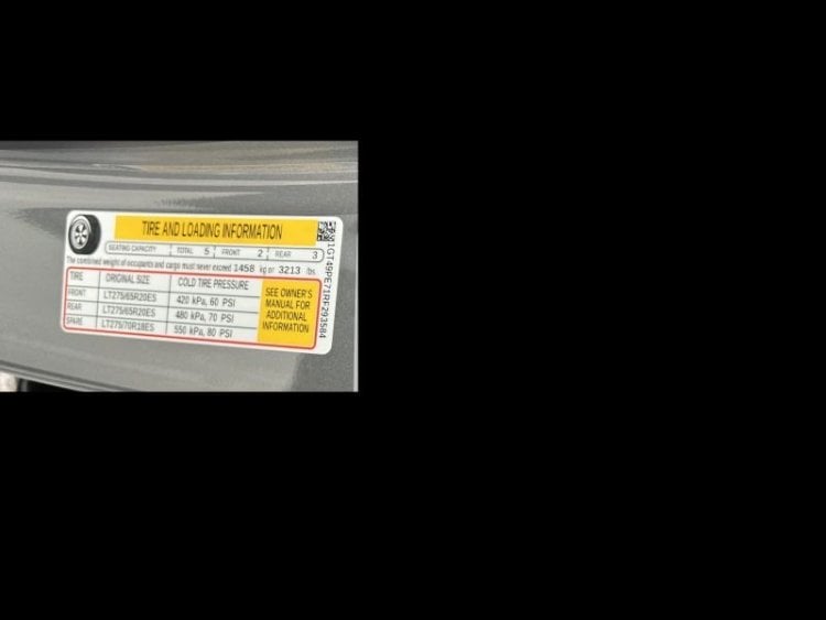

Today I decided to reduce the tire pressures to 55 psi for all 4 tires. The DIC showed 56 psi. Went for a ride around the neighborhood and it read 57 psi when I got back. No TPMS sensor errors. Got out my Autel TS508 to read the placard tire pressures through the OBDII. Tire pressures for front and rear on the TS508 read -17 psi. I have the option to set them whatever I want but left as is. I have the tire pressures showing on the right side of the DIC all of the time. The MyGMC shows the recommended tire pressures at 59 psi / 69 psi.
Not sure why the MyGMC page is different unless my Autel is not reading correctly through the OBDII. It's the first time I used it like that. I did read the sensors individually and they are reading correctly.

Not a question on what pressures to run. Thought it was odd that I didn’t receive a TPMS error with the rear tire pressures at 56 psi and that the tire placard read -17 psi for both front and rear axles on my Autel TS508. I thought the tire placard on the Autel would read the same as tire placard on the door jamb label. I have read a post about others getting TPMS errors at 62 psi for rear tires.
My 2021 3500 has a max recommended rear tire pressure of 80 psi and the rear tpms alert comes on at 62 psi (although it didn’t alert when they recently dipped below that a little in recent sub-20F temperatures).  The 2500 from that year had a maximum recommended rear tire pressure of 70 psi and a lower alert pressure. I don’t know what it is, but I’d guess it’s about 53 psi.
