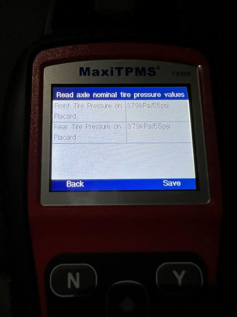

Got my Autel TS508 out today and attempted to change the tire pressure placard values to 60 front and 60 rear using the OBD II cable. I chose one of the 2023 GMC Sierras. It forces to do both. It said it was a success but when I "read" the parameters with the Autel, it still read -17 psi for front and rear.

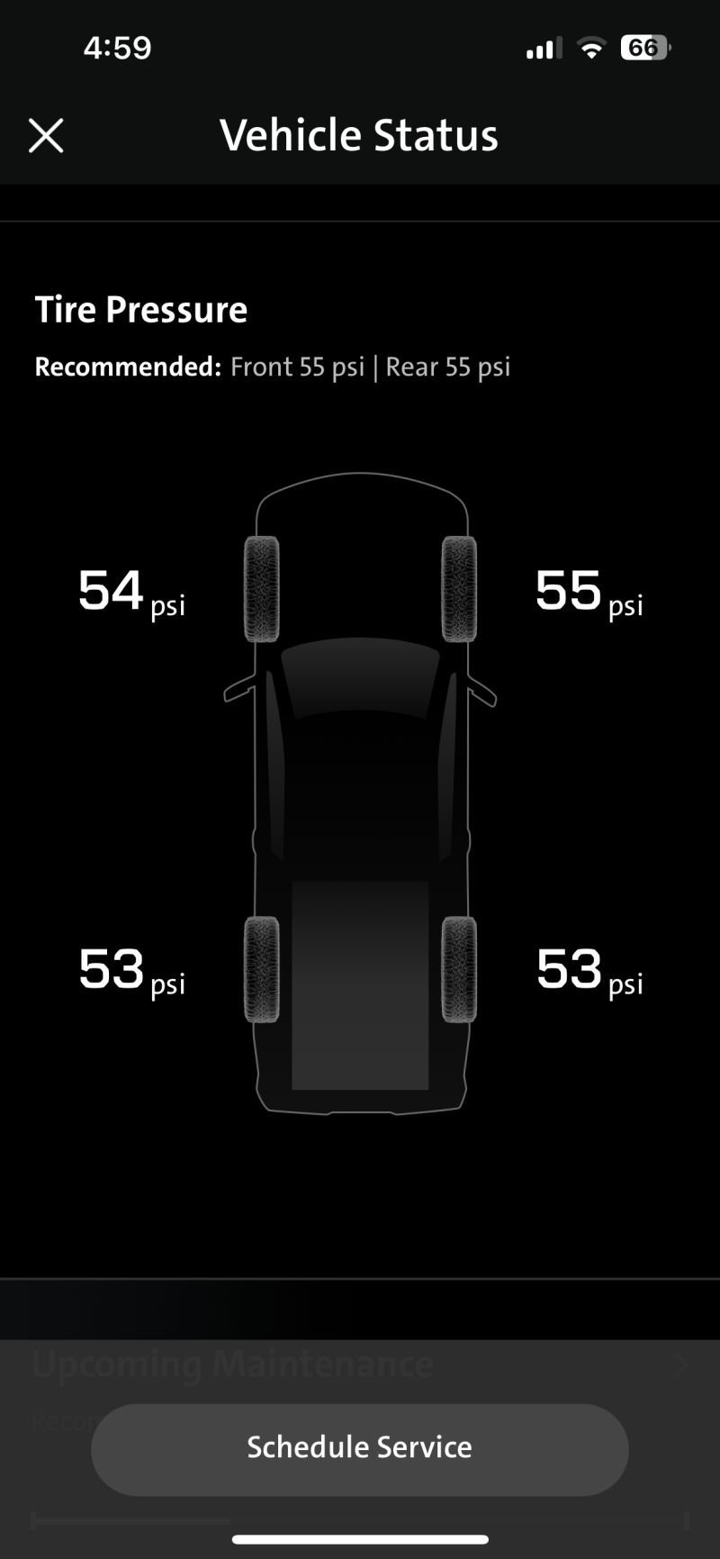

Decided to do an update to the Autel, there were several. Before the update,it only showed GMC Sierras made in 2023 or before. After the update, it now shows 2024 GMC Sierras but they don't show the tire placard option. I went back out to my truck did the read function again and it read 60 psi front/60 psi rear. myGMC app updated to Front 60 psi / Rear 60 psi. The tire pressures on the app were orange as three of the values were less than 55 psi.
Changed the tire pressure placard values to 55 psi. Was able to read the values with the Autel right away. The update did the trick. Drove my truck down my driveway and back in the garage. myGMC app updated and no more orange tire pressure values.
EDIT: Autel's website says that all vehicles do not support the tire pressure placard  value change function. Glad mine worked.

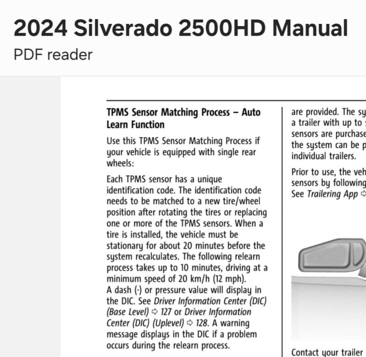

No.  The TPM system changed on the 2024 HD to an auto learning system.  Sensors are the same 433mHz frequency but are set up differently for the auto learn.
Programming a sensor for a 2023 and sticking it in a 2024 will not work.
