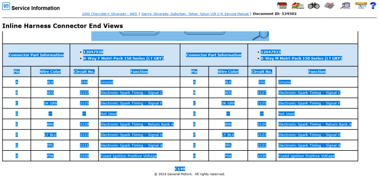

No, would be the wire underneath - last one on the right of the bottom row of wires. I can't tell the orientation of the picture, but I don't remember the wire being pink. DO NOT ground that until you're sure of what wire is what.
That does look like the plug - if it's sitting on top of the driver's side valve cover, then that's it. Just double check with a Alldata DIY subscription, or a printout of  a wiring diagram to be sure you'll be grounding a GROUND wire, and not anything else.

Okay  I must be retarded or something. I guess I have just been at my truck fixing thing too long! This photo shows the white plug I was suppose to find the ground wire on the bottom row of wires add a longer ground to it and run it to the neg side of the battery right? Well for some reason I went to the coil pack to the left of that white plug, and see the plug on top of the coil pack? I added a ground wire to that ground and ran it to the battery? I am not sure what I was thinking but I don’t even have the right plug more or less the right ground wire. Did I just mess things up worse by doing the coil pack plug instead of the white plug? I am my own worst enemy! IMG_1963.thumb.jpeg.d2e65c3e64ced51c118a9c32d5438468.jpeg

Well as you can see from my latest photo I don’t have a black wire on the white plug at all! lol … for now I will try and find out which one of the wires there is my ground and do what you said.
Yeah, don't do that - you'll fry the coil to a cinder.
Best money you can spend is on a AllData DIY wiring diagram. Trust me on that one! It's cheaper than replacing fried components.
Like I said, I'm not 100% sure what the wire color is there since I'm going off memory ... which is fickle on my best day.
