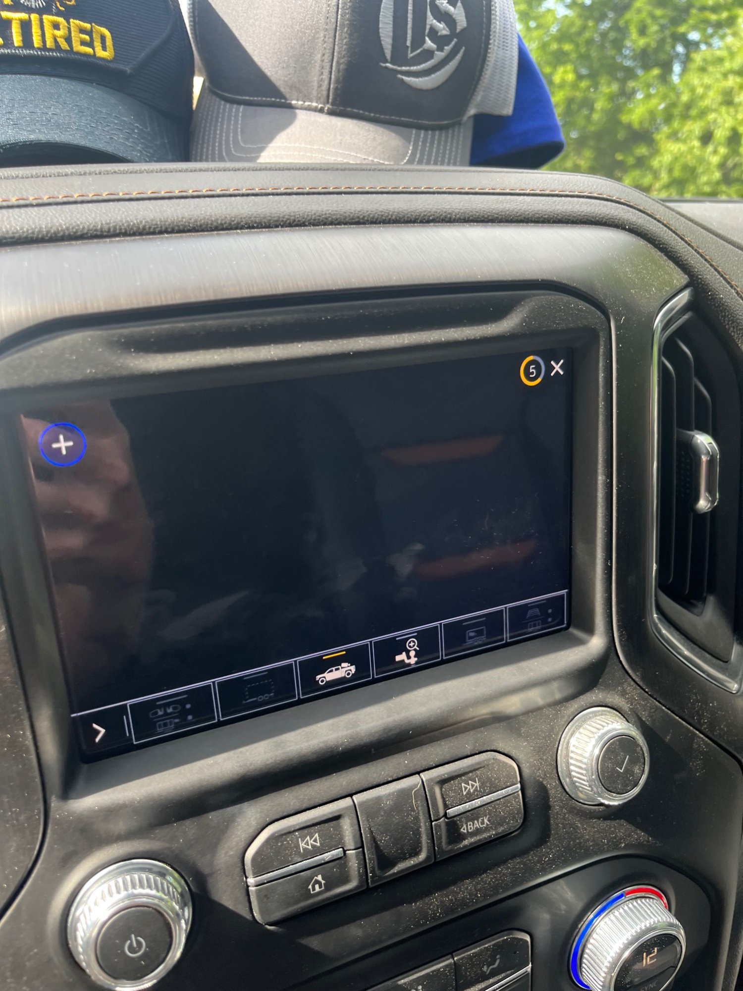

Have blue screen back up camera 2019 silverado just bought has anyone foud out a fix
Welcome to the forum. My backup camera had to be replaced at the dealer.

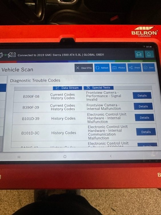

I have a 2019 sierra at4 with hd surround vision had this blue screen problem from day 1.  Been in 20 times for this issuse still no fix something I have notices when it rains or gets cold out that's when I have the issuse. No issuse all summer in nice weather just in the rain and now truck is off warrenty don't want to spend a bunch finding out the issuse if anyway body has figured it out that would be great
Just had my front windshield replaced tech called and said I have e over 40 codes for the camera system so he would not be able to collaborate the cameras system. Any idea where to start looking.
