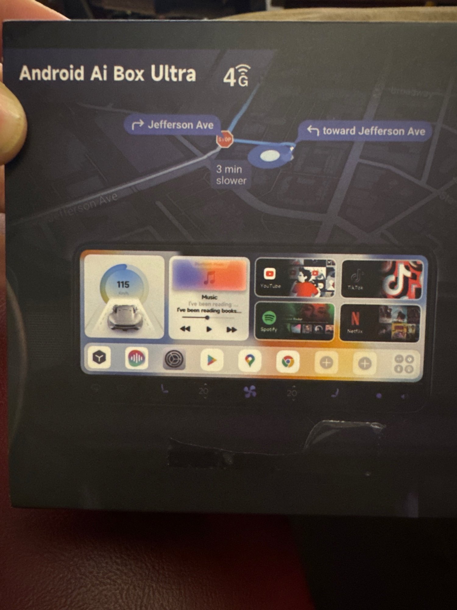

11 hours ago, Todd Sickler said:
So I was gifted an Android Ai Box Ultra for Christmas and I cannot for the life of me get the full screen. Any help would be much appreciated. It’s an Android box that allows CarPlay and Android Auto, but I can’t get the Android Auto to work with my IPhone obviously, only the CarPlay.
Here is the link to the box.  https://a.co/d/7gbIiyA
I’ve attached a picture too. image.thumb.jpg.5ac788856c26e6bf2548d00144552268.jpg
I’ve contacted AuroraLink (the seller of your Android Ai box to find out any info on wether it is possible to change the projection method to use Android Auto instead of CarPlay (allows the use of full screen). They should get back to me in 48 hours, maybe a little more because of the holidays. When I find out more, I will let you know.
Hey, thanks man. I’ve watched Don’s Life on YouTube showcase this item and he’s got it hooked up to an iPhone with CarPlay and he’s projecting full screen so I know it’s possible I just can’t figure it out. My truck is a 2022 GMC Sierra 1500 refreshed by the way.
This is the response I got, I’m not sure what they are talking about in the middle but I emphasized the key words.
Dec 31, 2024 12:22 AM
Hello
I am your exclusive after-sales service, and I will give you an answer to your question: The CarPlay channel is currently used, and the wired Apple CarPlay display area is the display area of our car box, and switching to the AA channel is not supported.
