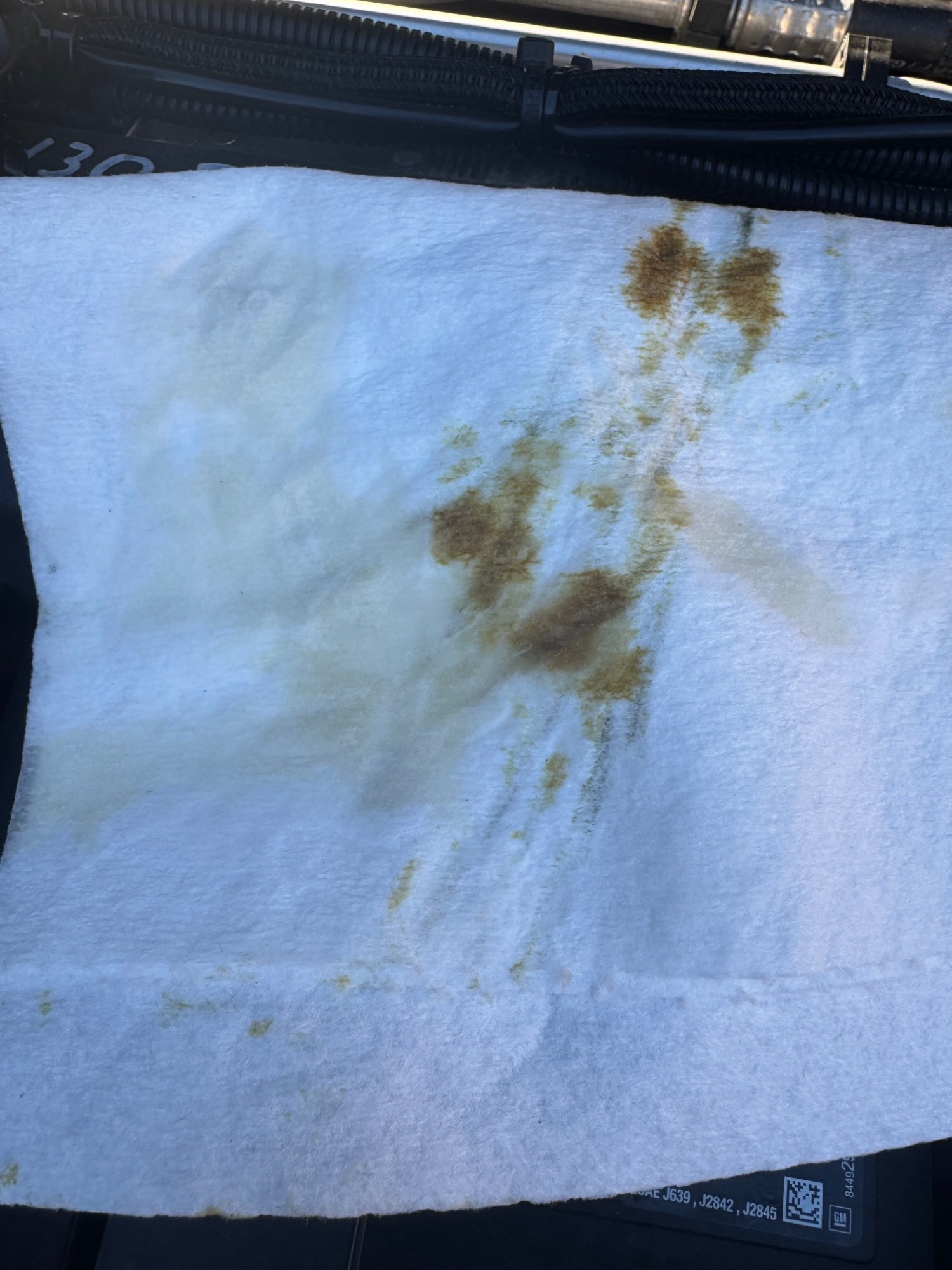

Wouldnt it still being amber be a bad thing after 4200 miles?
Combustion byproducts and their oxidation products, like soot, are what colors up your oil. The tighter the ring seal the longer that takes. So, I see it as a good thing. The part that is interesting is, it uses oil and still remains pretty clean for a good long while.
Right. But after 4200 miles, whose oil is ever really still amber in color. I mean I have 2K since my last oil change. You can see some amber there but it aint perfectly clean. Wouldnt really expect it to be either though. But shoot 4200 is almost changing time.

Here’s what my oil looks like off the dipstick. This is around 4500 miles on the interval using RLI 5W30. The darker color is from dipstick. The lighter color is new oil for comparison. I did have to add about 1/2 quart or so after checking it.
