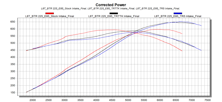

Heres an example on an L8T. The third intake manifold in the graph is a short runner design and it gives up even more in the mid range.

I have that cam in my 2018. BTR makes quality stuff. With headers it added +100 hp and +80 torque. I don't notice the tiny loss of torque below 2500. After 2500 it takes off like a rocket. The idle chop sounds so good. Been trouble free for 30k km

This is the dyno sheet. They said it was a 4th gear pull, and it would have 5-7% more power if it was done in 6th.

Do you know why Davenport didnt dyno in 6th? my under standing is the driveshaft is good until 125ish, was it your tires?

In 6th gear at 6100 RPM I’ll probably be going 180-200 Km/hr. The driveshaft might handle that RPM but the tires are not rated. Just safer for them to dyno it in 4th and do the math after.
